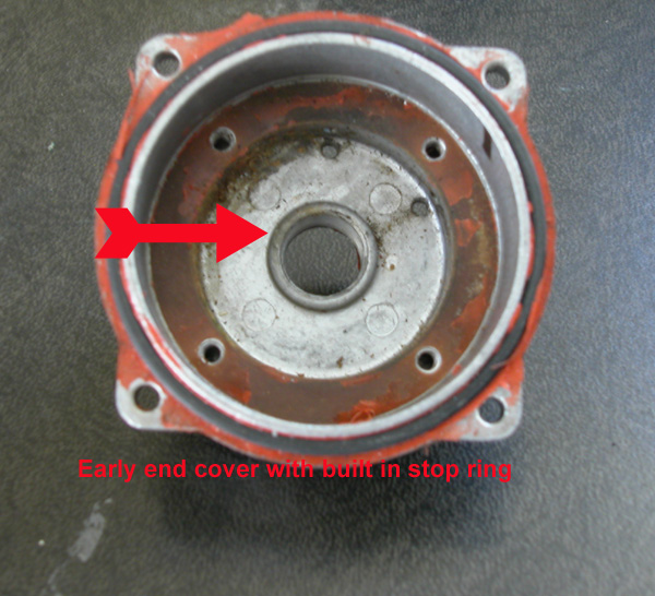

Pic of inside a early cover showing the cast in stop ring. The spacer looks like the paper gasket in the pic except its thicker of course. I don't have one handy for a pic.

Bleyseng   Pic of inside a early cover showing the cast in st...   Feb 19 2015, 12:06 PM
Scarlet75   Geoff, Other then being cast this way, some MPS ...   Feb 19 2015, 01:44 PM
