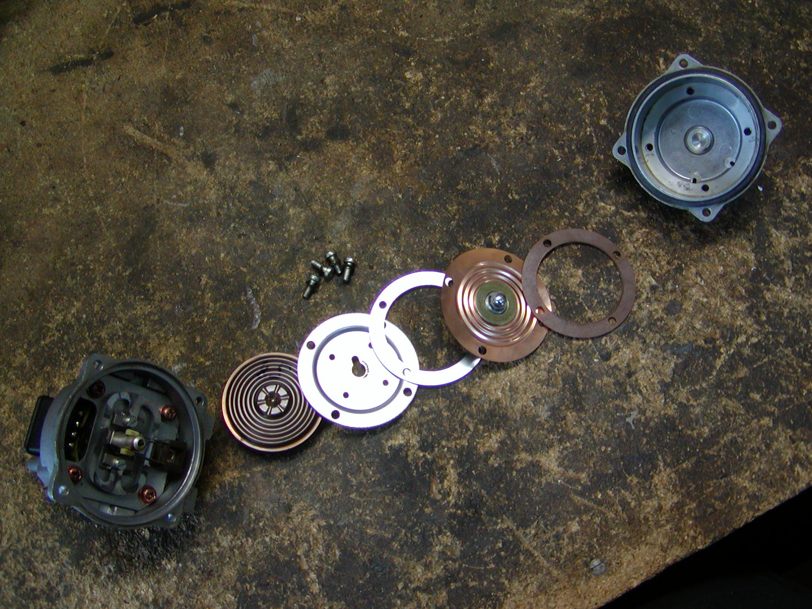

Chris is the Man for this MPS spacer ring, you already have the CAD work done from the diaphragms, just need editing. All those 1.7L MPS can then become 2.0L MPS!
Here is about the only photo I have on this computer of the ring FWIW.

Racer Chris   I have a spacer in my spare parts collection. Thic...   Feb 19 2015, 01:53 PM

Jeff Bowlsby   Chris is the Man for this MPS spacer ring, you alr...   Feb 19 2015, 02:52 PM
