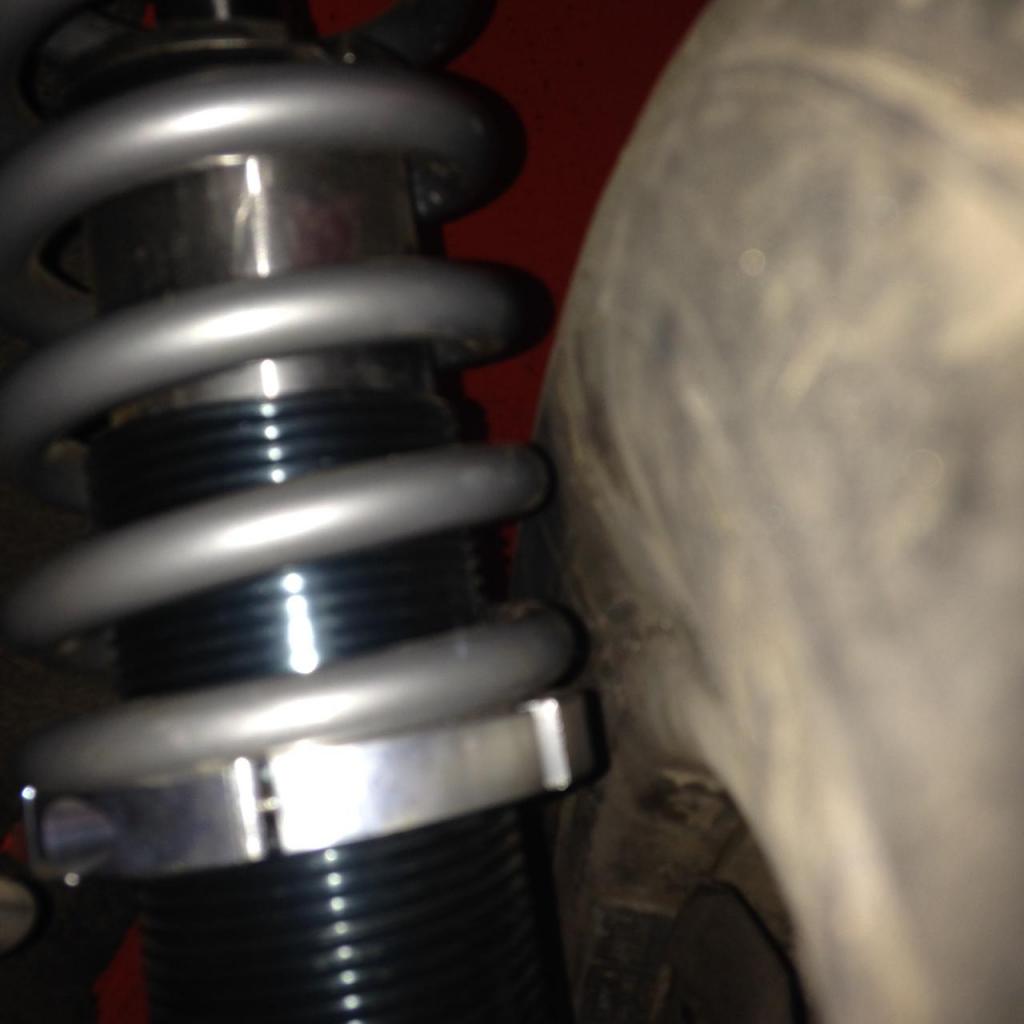

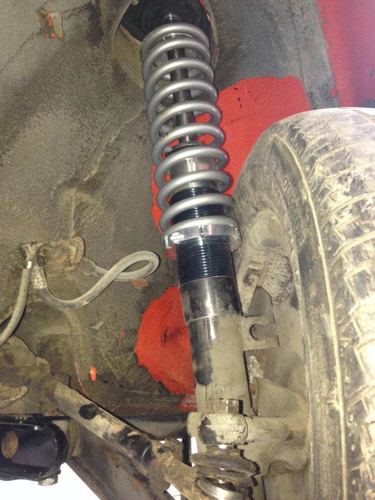

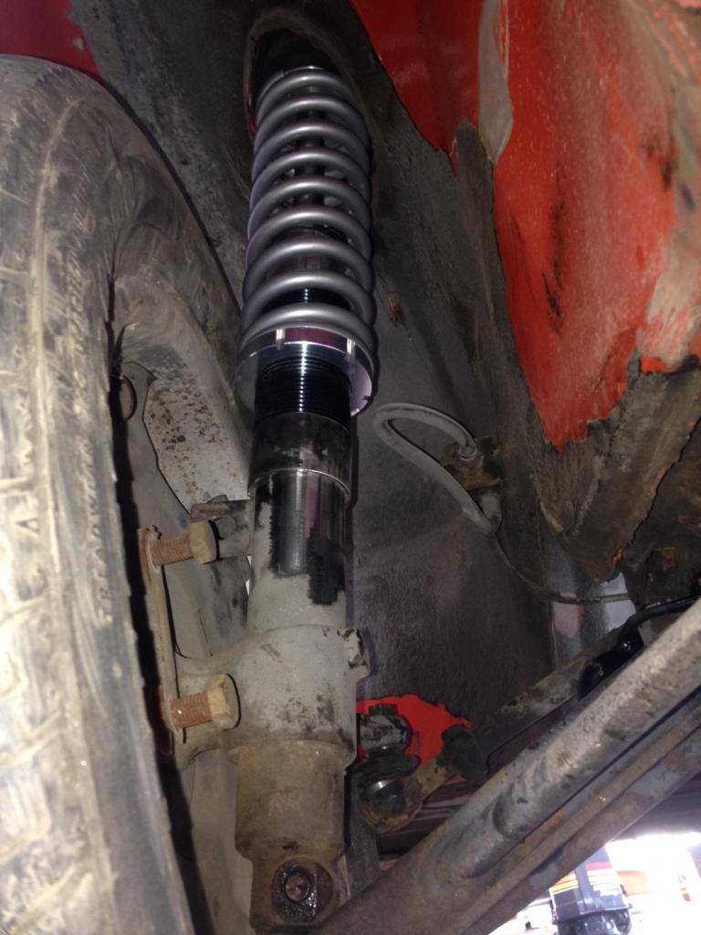

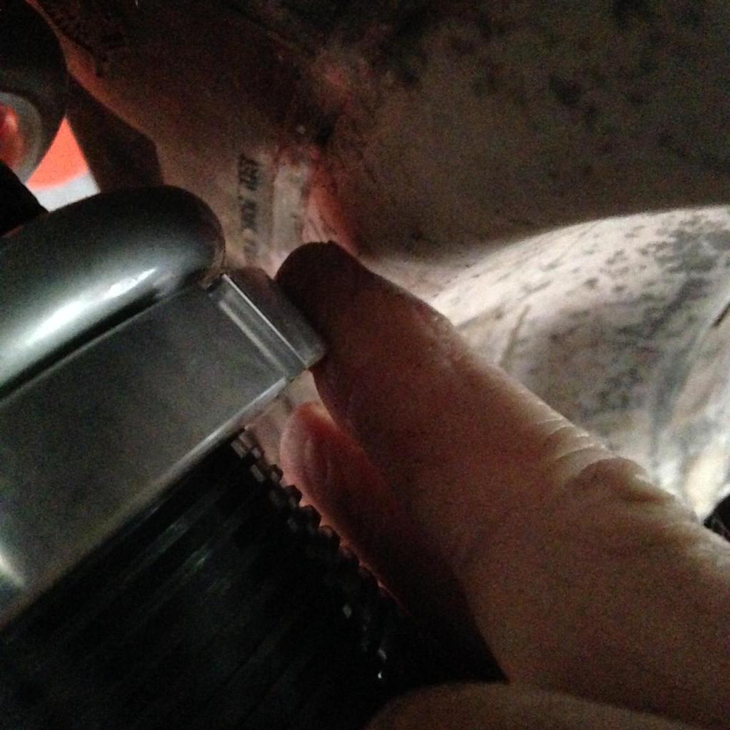

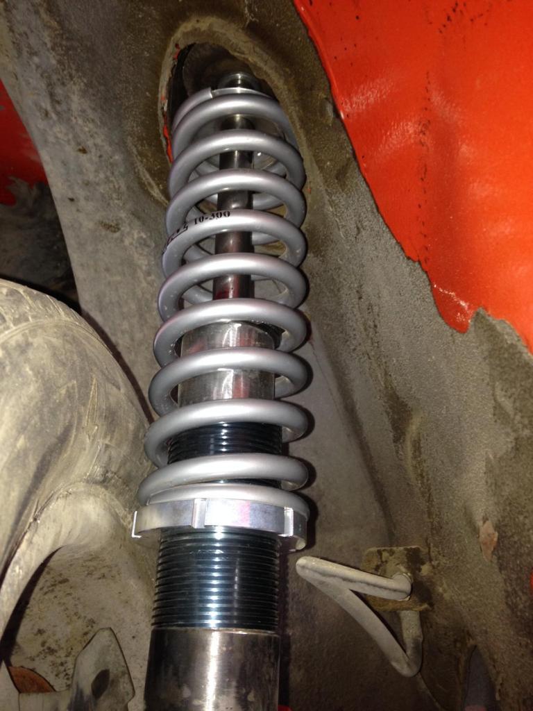

Installed the crossbar and found the 11/1971 and the 09/1974 don't use the same lower ball joint. (IMG:style_emoticons/default/headbang.gif) So I got the 74 lower arm and installed it.
Test fit the coil-over idea I have and it is going to be very close. With stock Alum. wheels ! Think a 1/4" spacer would be best with stock fenders. Tires in photos are 195/60r15'
I will be adding the steel GT flairs and 7 or 8" front wheels and 8 or 9" rear. At this point I'm not sure what spacers if any will be needed and foresure don't know with the coil-over's in the front ?

But it looks like it will work ! (IMG:style_emoticons/default/piratenanner.gif)
