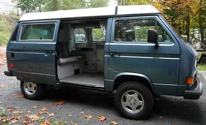

No such thing as a '78-79 Vanagon, it would still be a bay in those years. First Vanagon was 1980 and they were air cooled til halfway thru the '83 model year.
I'll weigh in on the SVX in a Vanagon. It absolutely transforms the vehicle! The useable torque is so satisfying for someone who spent years stirring gears in a Westy with a 2.1 waterboxer. Last summer I drove up to Mt. Rainier in my SVX Syncro Westy and was amazed at how pleasant it was to climb a steep, twisty mountain road in 3rd most of the time although I'd occasionally drop to 2nd on severe hairpins. I had 3rd & 4th regeared taller and it makes climbing hills effortless. On the highway it cruises easily at 80 with lots to spare. I don't think 100 is out of the question but the right situation hasn't come up for that attempt.
IMO VW got the Vanagon right....except for that crappy engine with jury-rigged exhaust and cooling systems to complement the screwy head seals. (IMG:style_emoticons/default/confused24.gif) (IMG:style_emoticons/default/chair.gif) Weight distribution is near 50/50, rack and pinion steering, independent suspension, great visibility, good seating (later models). My Westy makes a great base of operations for local use and extended road trips.
In normal use, it's fun to frustrate other drivers who think they're next to, or behind, a plain old ordinary VW bus. It's part of our dna to want to get in front of a VW bus, right? Not so easy when that bus has 240hp. (IMG:style_emoticons/default/slap.gif) I love it when someone has to pull in behind me because they can't accelerate around without attracting attention. At some point I may tow the 914 behind it. That would be like the Enterprise with a separating battle bridge. (IMG:style_emoticons/default/happy11.gif) The brakes were upgraded during the conversion and I'm sure the SVX would handle the towing fine.
All of that said, I'd probably go with the 2.5 if I was doing it again. HP/TQ is a little less but the mpg is dramatically improved. That eg33 is a beast of an engine but it does suck the gas; I get around 15 at highway cruising speeds. Reliable sources have told me 20+ is easily achievable with the 2.5. Whichever way you go, I don't think you can beat the Subies for reliable, powerful conversions that look like they belong in the Vanagon engine bay. Porsche power would be pretty sexy in one of these rigs but I'm doubtful they can pencil out anywhere close, especially in long term useage.
Here's a couple of gratuitous pics. They've been posted elsewhere but a cool Vanagon thread like this deserves the documentation.
