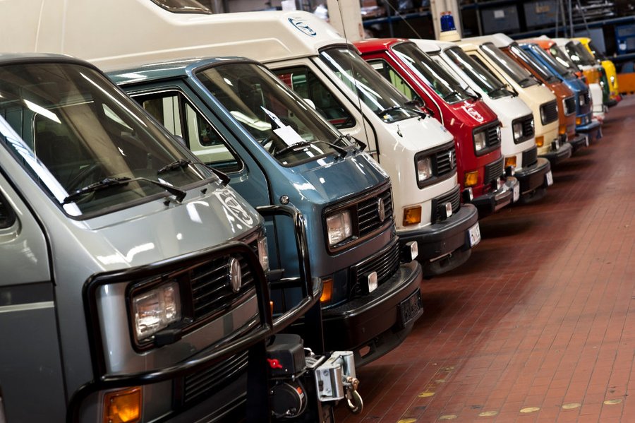

Ha! So I found my Hannover VW Oldtimer Museum pix for the Vanagon foglights pix below, & here is the Porsche B32 from there.

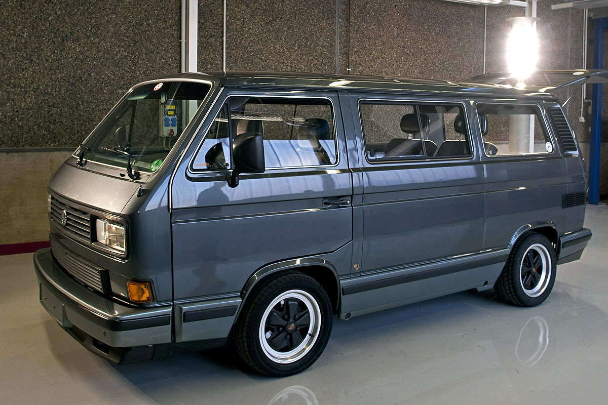

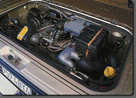

1985-87 (IIRC) PORSCHE B32 6 PASSENGER VAN ---v
Porsche apparently built 2 as "specials" to be support vehicles for the early `80's 959s offroad racing in Africa, etc., then in 1985 decided to try to build & sell a few to top end customers - most were this 6 passenger tin-top, with 1 of the 15+/- as a "California Joker" Westy Camper Van (in White). There's a lot of good info online about them.
Thanx for posting this! And here FYI & so you can change the NPC to SPC .... biggrin.gif
- full Carrera 3.2L 6 + all suspension, brakes, Fuchs wheels, etc. done by the Porsche factory on 15-20 +/- Vanagons - including at least one camper - & sold by Porsche for about $70,000 DM in the early to mid 1980s!
Google for it, an interesting story & one B32 tin top resides in the Hanover VW Classic Oldtimer Works shop/museum.
If doing a semi-clone/tribute one today, I'd do it with the 986/996 or 987/997 -6 & more modern running gear. That would be my "if I win the Lotto" project for our 88 Westy! idea.gif
Otherwise, from our perspective of being a few years away from retirement & then on a fixed income BS - the 48 month/48,000 mi warranty on a GoWesty 2.5L big bore/stroked flat 4 waterboxer would be our choice - just to have everything covered after popping down the cash for an engine swap if/when it's needed (the other swaps are only 6-12 month & 6-12k mi - if anything) - & after our spending lotsa $$$'s on the rolling resto 2012-14!

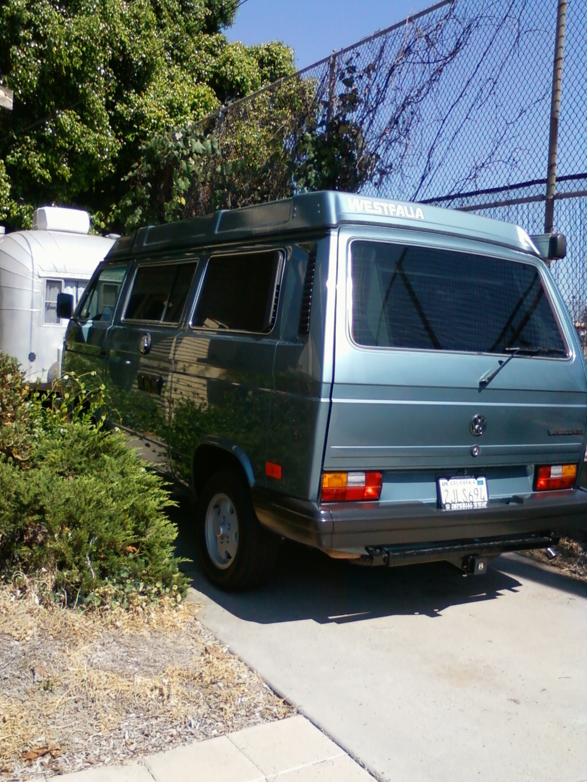

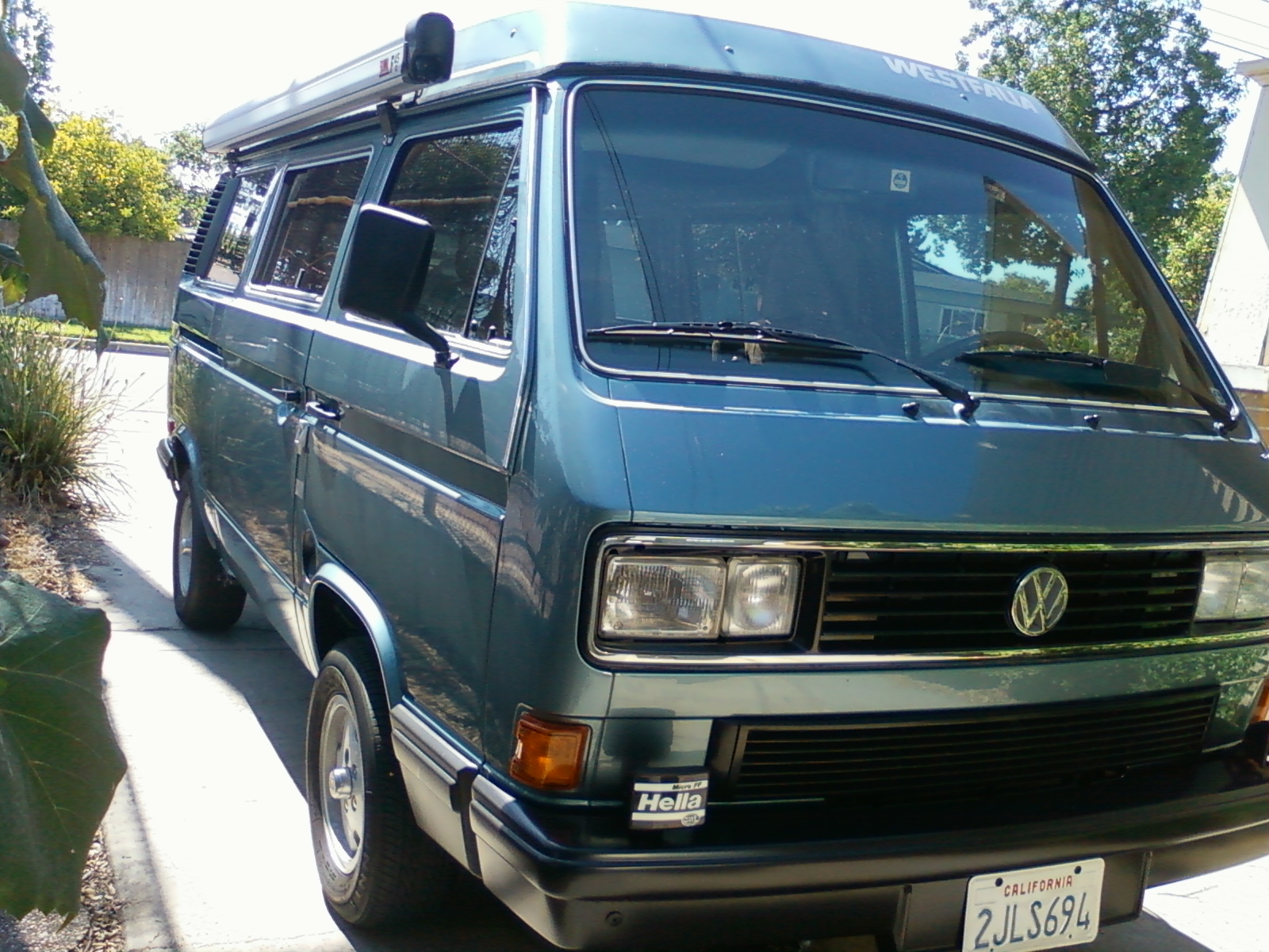

Coupla Westy as 98% completed rolling resto pix....

AWESOME Westy Tom. Love the look of those late Vanagons. Gotta have one.

Thanx Chris!
Yes on the kit or engine if you do it yourself, but in my case the GoWesty would be done by my long term 914/Westy/BMW mechanic (40 years later this year!), cuz he knows the car, & I get hammered with time required for my business & other BS.
The engine was replaced with a stock 2.1L rebuilt for thrown rod in the original at about 130k mi in `99 & top end done in 2006 for the typical reasons, so we're probably due soon now at 213k mi & almost 10 years later.
At least I'm right side up value wise, since these in this sort of like-new condition are valuing out now at $35-50+k & $50-100k +/- on the full GoWesty 2.4/2.5L engines or good Suby conversions.
I was surprised that it's post resto value would be more than the post-resto value on my 73 914-2.0 whenever it's done (at current values anyway). So that eased the pain of having to further postpone the 914 work to get the Westy done.
BTW - those are the Euro style fog light option as seen in that Hanover VW Oldtimer museum/shop pic below - but I used smaller & more powerful "modern" Hella MicroFF foglights (also available as driving lites) with the factory dash switch & an SS repop of the factory brackets from VW Bus Shop/Peter Gunzl in Germany.

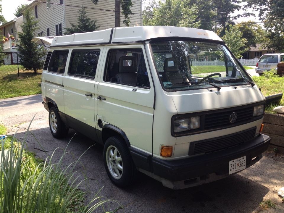

We are real gluttons for punishment. We're interested in not one but two cars that need way too much to be the way we want.
Does anyone here know if a Boxster engine can be adapted to a 915 trans ?
Here's why I ask.
I'm not a fan of multi-national engine swaps.
Subagon, Fordagon not for me. No diesels either.
My only gripe with the orig. 2.1l is that it's too wound up on the highway.
Boxster engines are plentiful, and yes, I know about IMS probability. And I understand that the intake is a too tall, but maybe that can be remedied.
A water-cooled German boxer six in place of a water-cooled boxer four ? That's the ticket.
Any insight is appreciated.
Pictures of my '89 attached.

I agree on the all German approach. IIRC the B32 used the 915 transmission + 3.2L 911 Carrera motor & all running gear, & they raised the rear deck about 3-4" - if you google for B32 pix online.
I said I'd opt for the waterboxer newer Boxter/Cayman/911 flavor 6's to keep it still all watercooled on the later Westies ..... IF I win the Lotto big!!
And get that dang snow off the Westy - the weight & ar resistance will just slow it down more! biggrin.gif

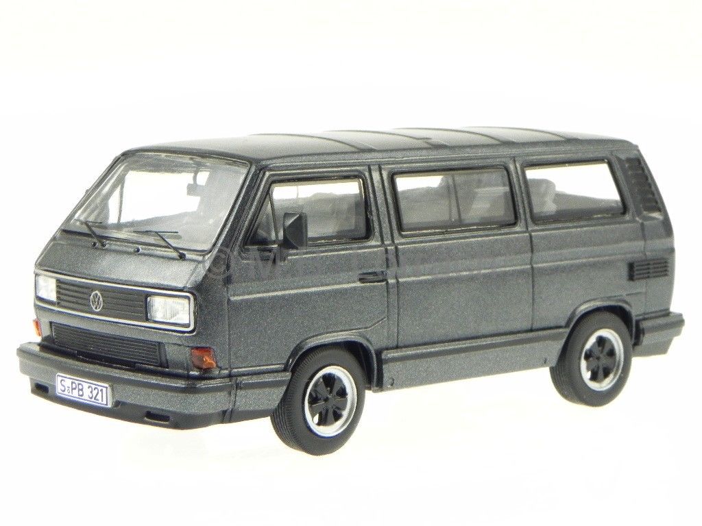

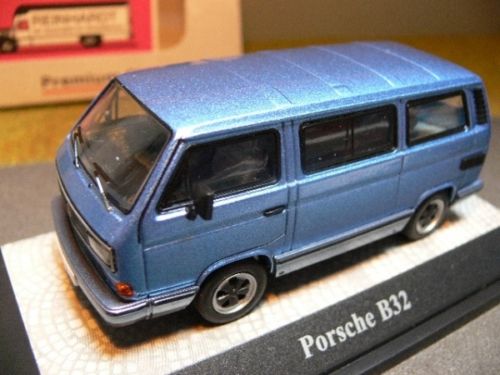

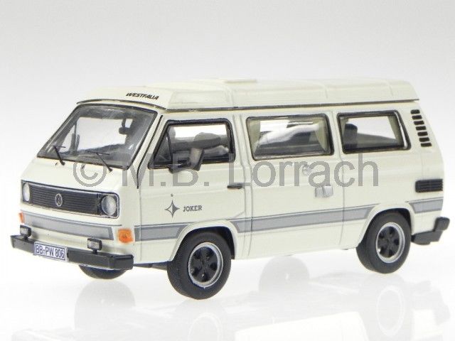

http://www.ebay.de/itm/VW-T3a-Porsche-B32-...=item27f8ef3f41
http://www.ebay.de/itm/VW-T3b-B32-Porsche-...=item2a4b09c3ef
http://www.ebay.de/itm/1-43-Premium-Classi...=item58b91521cc

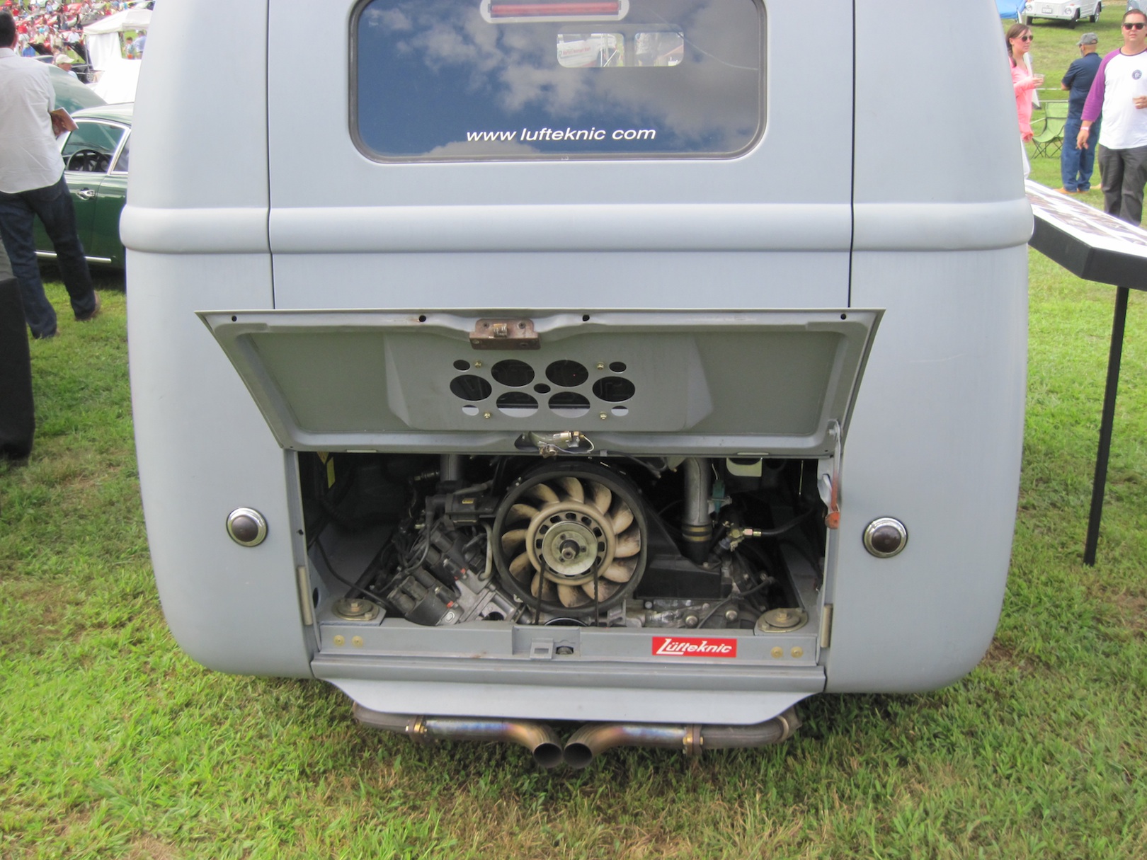

3.6 996 motor in a Vanagon
I thought I saw another video years ago with an aircooled 3.6 in a Vanagon, it was blasting up some windy road and getting the rear end out a few feet here and there?

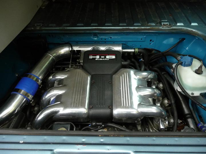

SVX engine...very tempting as well. Kelty360 has a very nice one... The in-car vid at the end is the best part. That guy is HAULING ASS in that Vanagon!

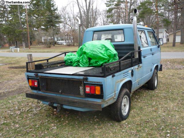

We put about 25 of these Carrera powered Vanagons into service with our MSDS conversion kits, from 1990-2000.
This is my '86 awd Syncro, complete with dual zone AC, heat, power steering and diff-lock.

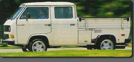

Marty,
You still have the Dual Cab Syncro around, that was my favorite conversion of yours. I need to get a Dual cab, replace my Chevy pickup. I would post likely do a SVX, as I have a few of them around right now. AWD is the Easy part.

Marty,
Stephen,
I actually had such a good offer on the Dual cab syncro, I sold it. Then took a 2wd Dual cab and converted it to LT1 chev power, with a g50 5 speed.Click to view attachment Click to view attachment
Marty

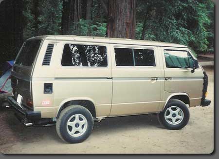

Marty

Cool, Vanagon thread ! Here is my 1990 Vanagon.
Too much to list done to this guy.

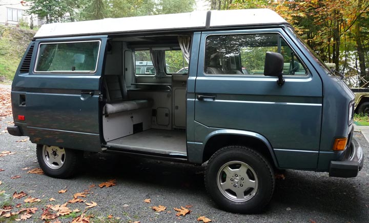

Here's a nice starting point... It's pretty far away from me or I would go look at it. For someone looking to totally re-do a Vannie to a driver it would be worth a look for sure. I THINK this car used to reside in Naperville and I looked at it several years ago.
Vanagon no engine

I'll weigh in on the SVX in a Vanagon. It absolutely transforms the vehicle! The useable torque is so satisfying for someone who spent years stirring gears in a Westy with a 2.1 waterboxer. Last summer I drove up to Mt. Rainier in my SVX Syncro Westy and was amazed at how pleasant it was to climb a steep, twisty mountain road in 3rd most of the time although I'd occasionally drop to 2nd on severe hairpins. I had 3rd & 4th regeared taller and it makes climbing hills effortless. On the highway it cruises easily at 80 with lots to spare. I don't think 100 is out of the question but the right situation hasn't come up for that attempt.
IMO VW got the Vanagon right....except for that crappy engine with jury-rigged exhaust and cooling systems to complement the screwy head seals. confused24.gif chair.gif Weight distribution is near 50/50, rack and pinion steering, independent suspension, great visibility, good seating (later models). My Westy makes a great base of operations for local use and extended road trips.
In normal use, it's fun to frustrate other drivers who think they're next to, or behind, a plain old ordinary VW bus. It's part of our dna to want to get in front of a VW bus, right? Not so easy when that bus has 240hp. slap.gif I love it when someone has to pull in behind me because they can't accelerate around without attracting attention. At some point I may tow the 914 behind it. That would be like the Enterprise with a separating battle bridge. happy11.gif The brakes were upgraded during the conversion and I'm sure the SVX would handle the towing fine.
All of that said, I'd probably go with the 2.5 if I was doing it again. HP/TQ is a little less but the mpg is dramatically improved. That eg33 is a beast of an engine but it does suck the gas; I get around 15 at highway cruising speeds. Reliable sources have told me 20+ is easily achievable with the 2.5. Whichever way you go, I don't think you can beat the Subies for reliable, powerful conversions that look like they belong in the Vanagon engine bay. Porsche power would be pretty sexy in one of these rigs but I'm doubtful they can pencil out anywhere close, especially in long term useage.
Here's a couple of gratuitous pics. They've been posted elsewhere but a cool Vanagon thread like this deserves the documentation.

Nice polished manifold Kelty...or is it ceramic coated? What was the process?
I love that thing.

Thanks Chris. It's polished. I did the initial smoothing of the rough casting and then had a polishing shop finish it off. The eg33 manifold is such a fine shape, it screams for polishing. I freely admit.....I'm fascinated by shiny things.

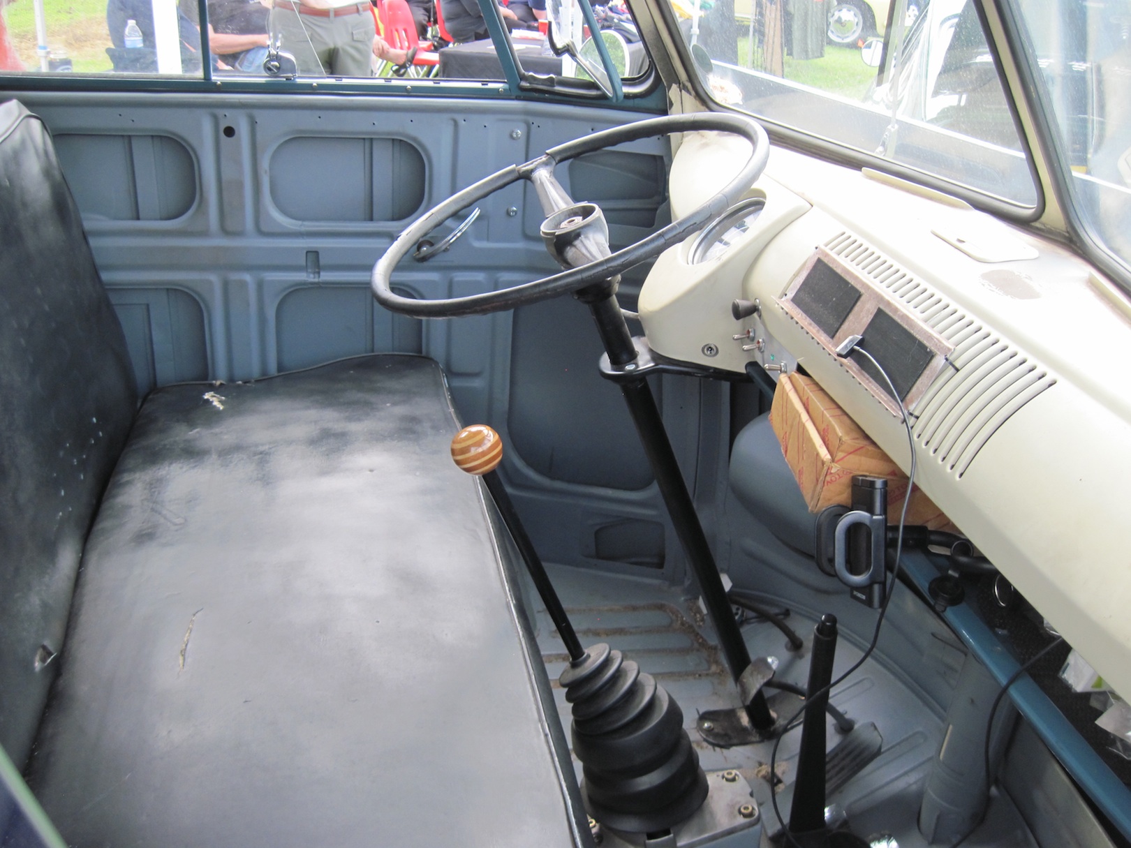

anderssj

Does that barn door have a 4-cam in it???? I see two distributors...
rgalla9146
Later air cooled 911 (993, 3.6) engines had a twin distributor to make it a 12 plug.

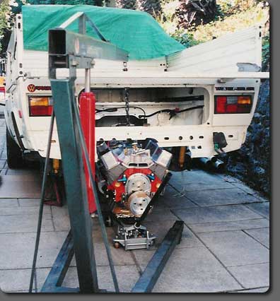

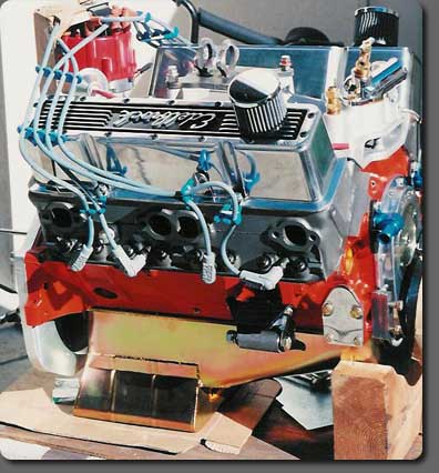

The 400hp small block that I built for the 2cab, was built from a vintage iron '69 4bolt main LT1. Later model angle plug heads, 8.5:1 cr for today's low octane unleaded, Holly pro-jection, Isky cam with PJ gear drive, Milodon 7 qt. baffle oil pan, MSD ignition and an Edelbrock air gap manifold...and some of my shorty v8 block hugger ceramic coated headers. All way under budget too....I'll use the savings for a nice White/pearl paint job !Click to view attachment

Hot motor Marty, it reminds me of the one I helped my uncle build as a teen in the 1960's for his 32 Deuce Roadster with the rumble seat hot rod!
Good thing about the Dokas etc. is that the working deck/floor is higher to be able to put in a taller block/manifold/etc. & you can steal some space for it from that underfloor storage compartment.
However, I always thought that they cast those Edlebrock valve covers such that the read right side up when mounted on the motor, unless something has changed since the 60's-70's!!?? poke.gif
