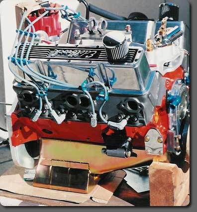

The 400hp small block that I built for the 2cab, was built from a vintage iron '69 4bolt main LT1. Later model angle plug heads, 8.5:1 cr for today's low octane unleaded, Holly pro-jection, Isky cam with PJ gear drive, Milodon 7 qt. baffle oil pan, MSD ignition and an Edelbrock air gap manifold...and some of my shorty v8 block hugger ceramic coated headers. All way under budget too....I'll use the savings for a nice White/pearl paint job !Attached Image
