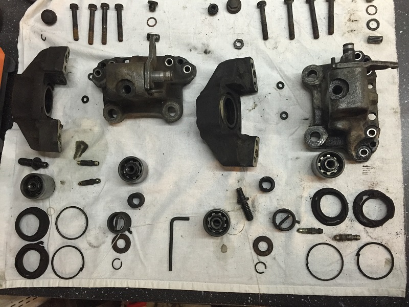

Watched PMB's video on rear caliper overhaul and proceded to take mine apart, turns out they must have been overhauled at some time during the cars lifespan.
Pistons were like new underneath the torn dust caps. Seal surfaces between the halfs were still nicely gold coloured. I'll replace the piston seals and dustcaps and reassemble and paint them black with some high temp paint.
