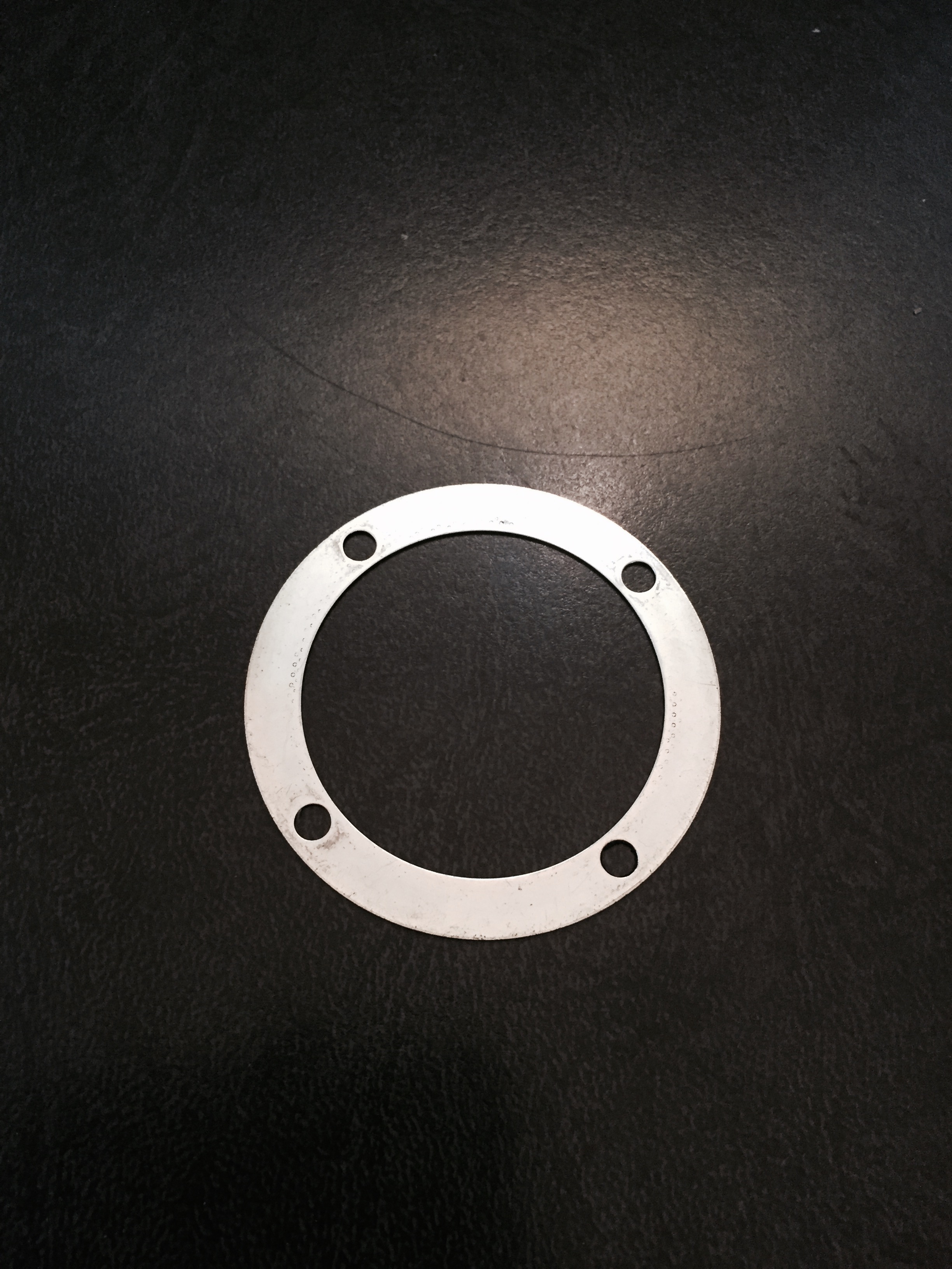

Getting everything together to install a 2056 into my '72 and swap out the steady, reliable 1.7L I've been running. The 2056 is '73 but came with '74 ECU/MPS combo. The part numbers are 049 on the MPS and 044 on the ECU. Sometimes I'm not sure if I read that ECU/MPS compatibility table on Anders D-Jet site correctly. Is the 049/044 a winning combination?
Also, I've read here that a 2056 really should run with an adjustable MPS. A couple of months ago I converted my 1.7L MPS to adjustable with the Tangerine kit. Any thoughts on whether I could effectively run my MPS (007) just by adjusting it appropriately, or are there other compatibility issues? Or do I need to make that '74 MPS adjustable?

Pic of the 2.0L spacer ring

Bleyseng   Pic of the 2.0L spacer ring   Feb 22 2015, 05:35 PM
