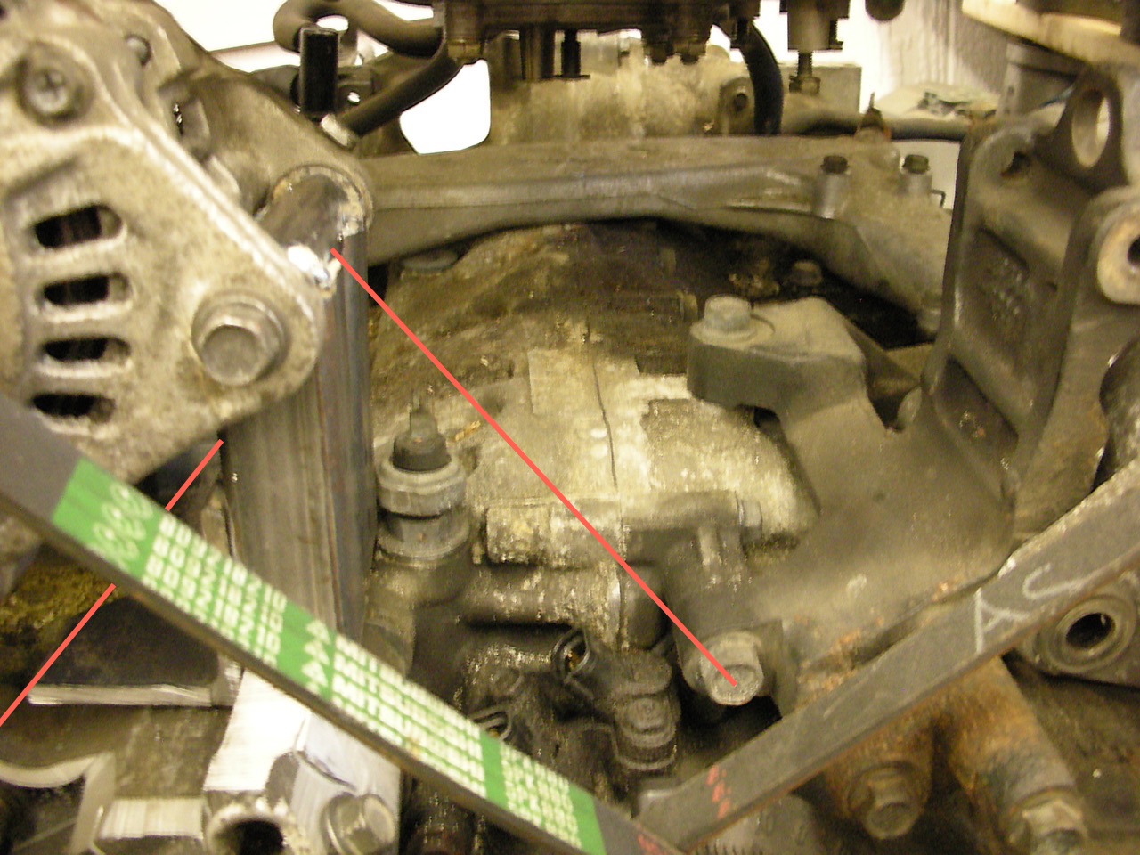

Bad SD Card reader / cable. (IMG:style_emoticons/default/mad.gif) I tossed something on the cable. and like magic it popped up, and I seized the opportunity to grab the files.
So here we go!!!!
Overal Picture, plenty of clearance for cabling etc....

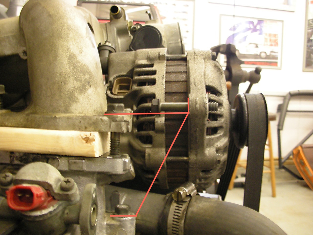

I will add triangulation in the plane the lines represent. This will tie the bracket in at three places. Even though its plenty strong , reduce metal fatigue do to vibration.
Will do the same on this side. Bracket will be made to catch the two points one down at the block and the other off the upper manifold. I will just need to finish welding, clean it up, and add it to the pile to get powder coated. The wood is my prototype spacer, it will not make it to the production vehicle. Though I have been thinking that maybe it should as a sheet of G10 Phenolic Material from USP is $1344.99 (IMG:style_emoticons/default/sheeplove.gif) I can replace a bunch of them as the get gross, from Lowes for $1.49 in raw material. Not the correct Material for the job. I'll keep searching for a better price, and or sandwich the phenolic material between another piece of aluminum. Which is most likey the solution. As a 1/8" sheet is only $190.78 and I am sure I can sell off the extra material for other peoples projects. Or make up a bunch of EG33 phenolic spacers and sell them off, long return on my investment, lol.
