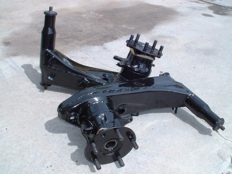

Forgot... here's a picture of a completed system.

Eric_Shea   It includes stock studs 45-50mm depending on how y...   Aug 31 2004, 08:08 PM
Eric_Shea   Forgot... here's a picture of a completed syst...   Aug 31 2004, 08:10 PM
Eric_Shea   In looking at your pictures of the rear "stuff"......   Aug 31 2004, 08:23 PM
