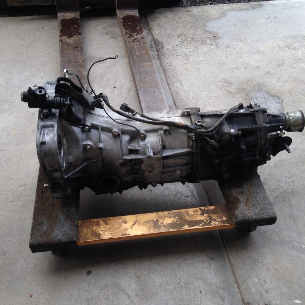

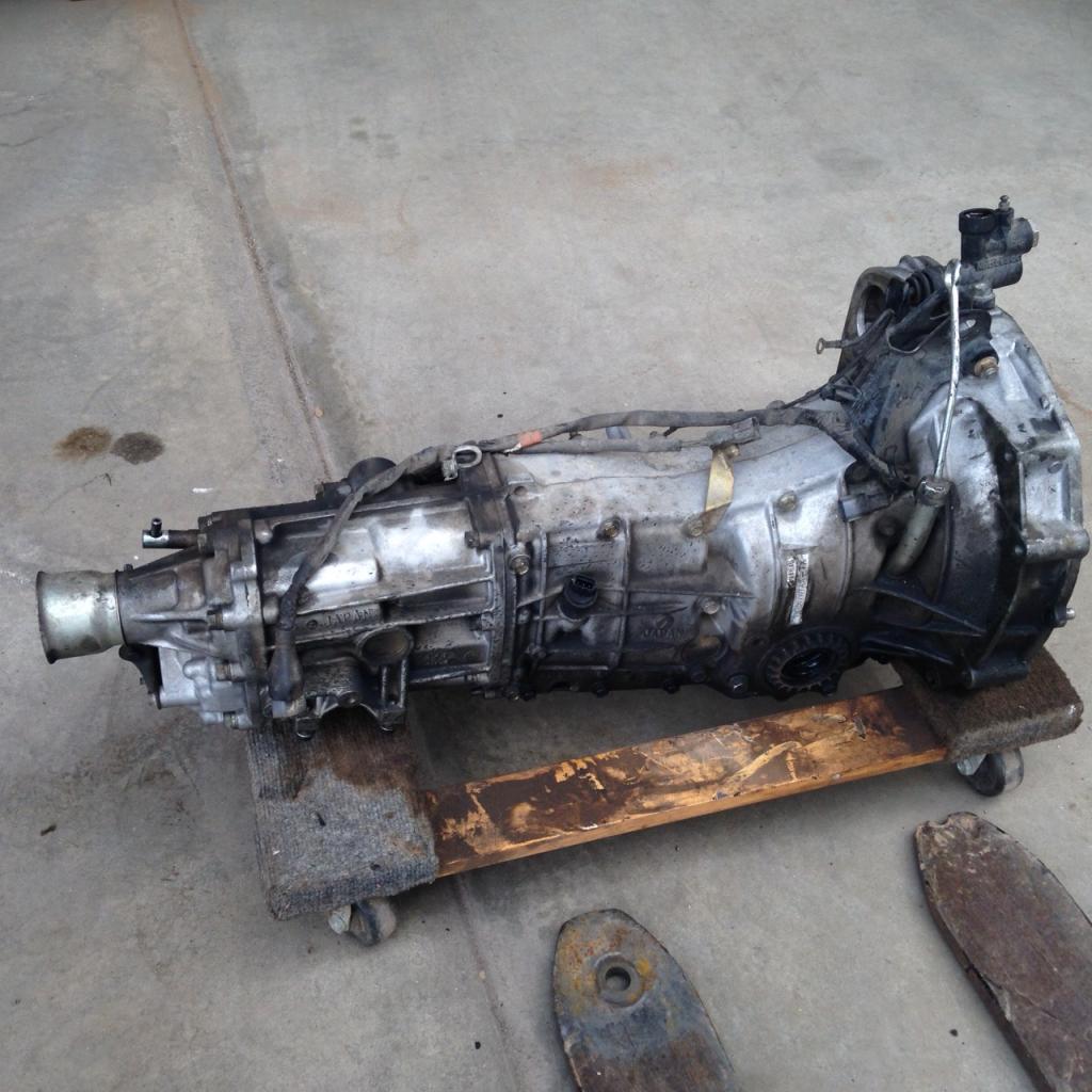

Look what I found . 2005 WRX tran's with LSD . COOL.
(IMG:http://www.914world.com/bbs2/uploads_offsite/i257.photobucket.com-8123-1425248144.1.jpg)
(IMG:http://www.914world.com/bbs2/uploads_offsite/i257.photobucket.com-8123-1425248144.2.jpg)
Also got yelled at by my Wife. So no EG33 for me. (IMG:style_emoticons/default/sad.gif) Just going to use the STI motor. Also going with MS3-pro. This should be interesting ?

Chi-town   That trans is not 05 WRX. The giveaway is it's...   Nov 11 2018, 05:41 PM
