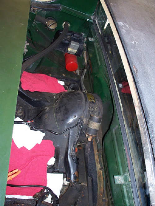

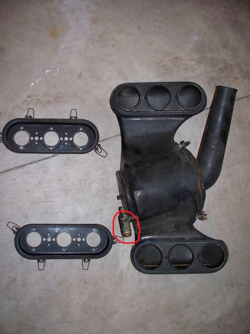

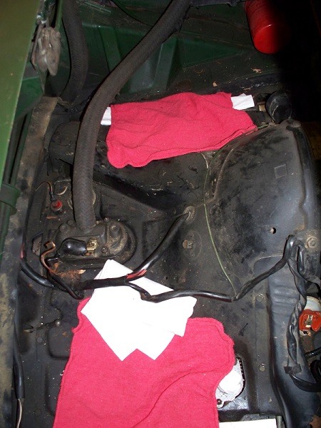

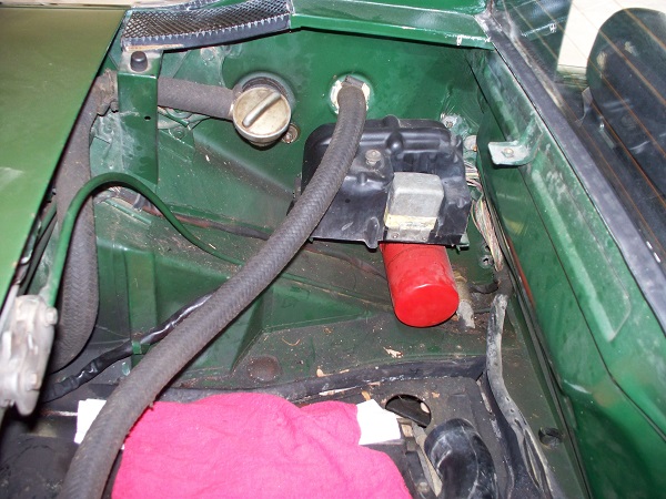

The engine vents to the oil tank then there's another hose that comes off the filler neck that goes to the factory air cleaner (circled in red). If you are not using the factory air cleaner then you need to vent it to an aftermarket breather tank.
I posted pics of my factory 6 oil line arrangement. Yes, the fabric line is not cheap.
