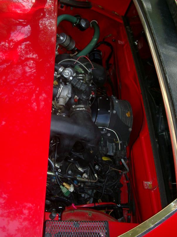

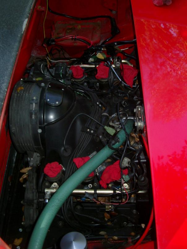

What's the best way to vent the case on the 3.0? I know there's a pipe coming out of the top of the engine, but what should I be connecting it to?

The case vent goes straight to the oil tank:
(IMG:http://www.914world.com/bbs2/uploads/post-179-1202450158_thumb.jpg)
(IMG:http://www.914world.com/bbs2/uploads/post-179-1202450792_thumb.jpg)
The filler neck vent goes to the air filter or a catch can, depending on your intake system.
