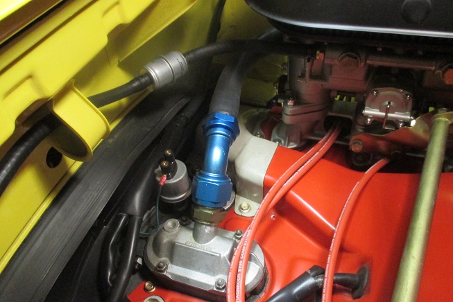

What's the best way to vent the case on the 3.0? I know there's a pipe coming out of the top of the engine, but what should I be connecting it to?

I wouldn't say it's the best way but has worked well for me so far

Luke M   The engine vents to the oil tank then there's ...   Mar 4 2015, 08:15 AM
JmuRiz   The engine vents to the oil tank then there's...   Mar 4 2015, 08:59 AM
MJHanna   You can run it to a catch can/breather also.   Mar 4 2015, 08:19 AM
screenguy914   You can run it to a catch can/breather also. Ye...   Mar 4 2015, 11:33 AM
SirAndy   The case vent goes straight to the oil tank: http...   Mar 4 2015, 11:43 AM
patssle   You can get colored heater hose cheap on ebay. Thi...   Mar 4 2015, 02:30 PM
SirAndy   You can get colored heater hose cheap on ebay. J...   Mar 4 2015, 04:45 PM
patssle   You can get colored heater hose cheap on ebay. ...   Mar 4 2015, 07:13 PM
SirAndy   [quote name='SirAndy' post='2154790' date='Mar 4 2...   Mar 4 2015, 10:22 PM
Cap'n Krusty   You can get colored heater hose cheap on ebay. Th...   Mar 5 2015, 10:32 AM
PanelBilly   Originally I was just planning to clamp the breath...   Mar 4 2015, 04:49 PM
jd74914   Yes, I would run it to the intake or a catch can. ...   Mar 4 2015, 05:14 PM
johnhora   914-6 GT used this... http://www.pbase.com/9146gt...   Mar 4 2015, 05:36 PM
Jeffs9146   Here is mine! :shades2:   Mar 4 2015, 06:44 PM
t collins   I wouldn't say it's the best way but has w...   Mar 4 2015, 07:48 PM
rgalla9146   Leakage at the breather nipple on the engine shoul...   Mar 4 2015, 09:18 PM
Mark Henry   Starting to hook this stuff up as well, Howard tha...   Mar 5 2015, 10:17 AM
SirAndy   Why not make a catch can that drains back into the...   Mar 5 2015, 11:17 AM
Mark Henry   Why not make a catch can that drains back into th...   Mar 5 2015, 12:23 PM
SirAndy   why would a six be any different? For starters, i...   Mar 16 2015, 12:43 AM
'73-914kid   I know that the discussion is about where to vent ...   Mar 15 2015, 11:35 PM
