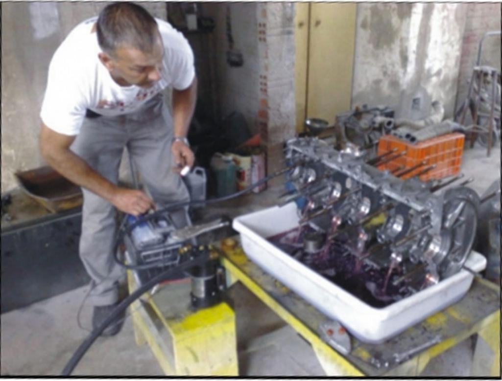

This is a custom flat 8 built in Brazil. The prototype was two VW engines (each 1500cc) built together to form one fire breathing monster known as the the 'Jamaro'.
Have a close look at those parts.Floating wrist pins.Gas or TIG welded heads.
Yes,this is it,the 'Jamaro of Brazil'.
Marco has a battery and pump,checking oil flow(trans fluid).

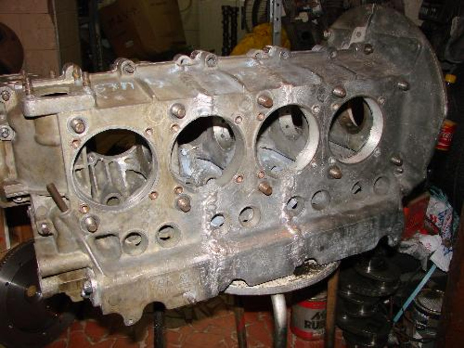

low-res photo,note cut and shut welds on case.How they dunnit,a few years ago.
Resize the welded crank and rod journals to fit the remachined cases post welding.
Main journals and bearings larger than stock.Means facing and line-boring the cases.
Any tig-man could do this in 2015.Weld a set of cases to 0.005"?Sure.Build a set of jigs and oven weld in steps,checking all the way.

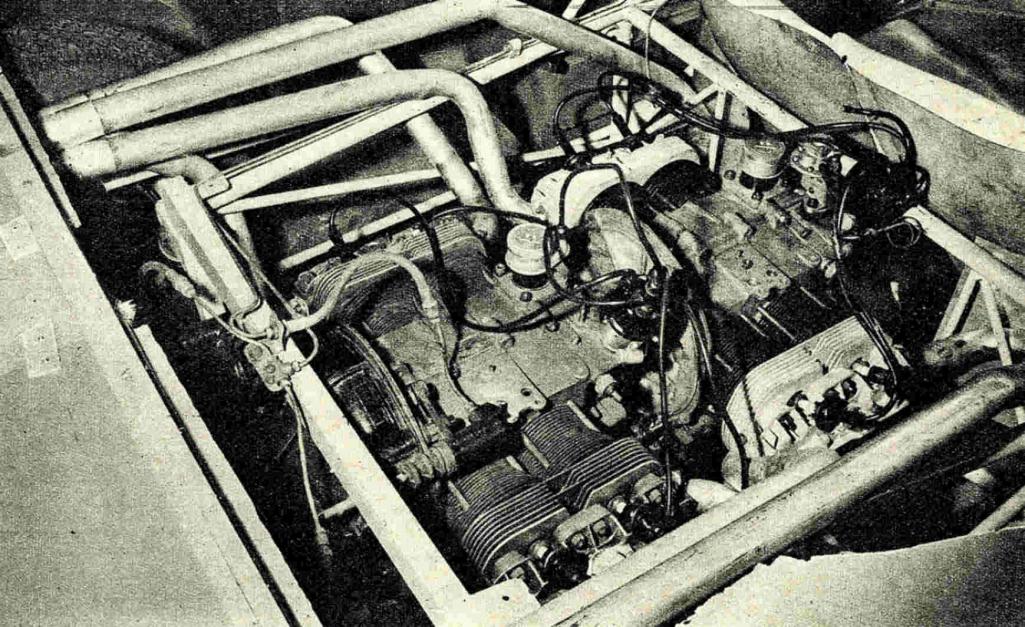

Emerson Fittipaldi's 1970 3.2L mid-engine Beetle.Ganged engine.

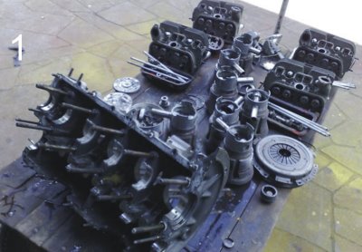

And in 1969, the brothers Jairo and Jair Amaro built a unique engine. A VW air 8-cylinder boxer with 3000 cc, may be the only motor 8 cylinders with these settings in the world!
In fact he was born in 69 with the addition of 2 1,300 cc blocks, and this one camshaft (which are actually 2 P3 soldiers in one piece), and a crankshaft that turns the eight lying cylinders to feed 2 webber 48.
The history of this car actually is this conceptual engine. In the story, the designers put him in a car race formula style. This engine came to walk in 70 years, but a chronic problem of lack of oil pressure
wore a little his image and many of its competitors at that time had stronger engines, made this engine was left aside. Amaro brothers built in the decade of 60-70s over 25 race cars Formula Vee,
and even the sports car maker Puma became interested in the VW 8-cylinder engine, but missed. Brothers Fitipaldi also set up a Volkswagen Beetle Bimotor, but its manufacture was totally different from Jamaro.
In 2004, Paul Trevisan, businessman Passo Fundo and passionate about motoring acquired the engine in the city of Guaratingueta, SP and brought to the Brazilian Motor doMuseu the collection
owned by the same engine .That was all dismantled and restored, after that it has been tested bench. It was also studied and relieved the problem of oil pressure, or the engine tava ready.Now lacked a car.
After long evaluation it was decided to make a Volkswagen Beetle Beechcraft, for reasons that enthusiasts can imagine, which put the name of the original prototype.
Some changes occurred in the engine to try to solve the oil problem, demanded 2 exchange bearings of the connecting rods, a new high-pressure pump driven by toothed belt improved the car's performance.
In fact, it is a fairing Beetle on a tubular chassis racing Espron. Only in March 2009 this engine was turned on to be displayed at the Auto Sport TV Globo, which will soon be aired. On the program's filming, the car showed
