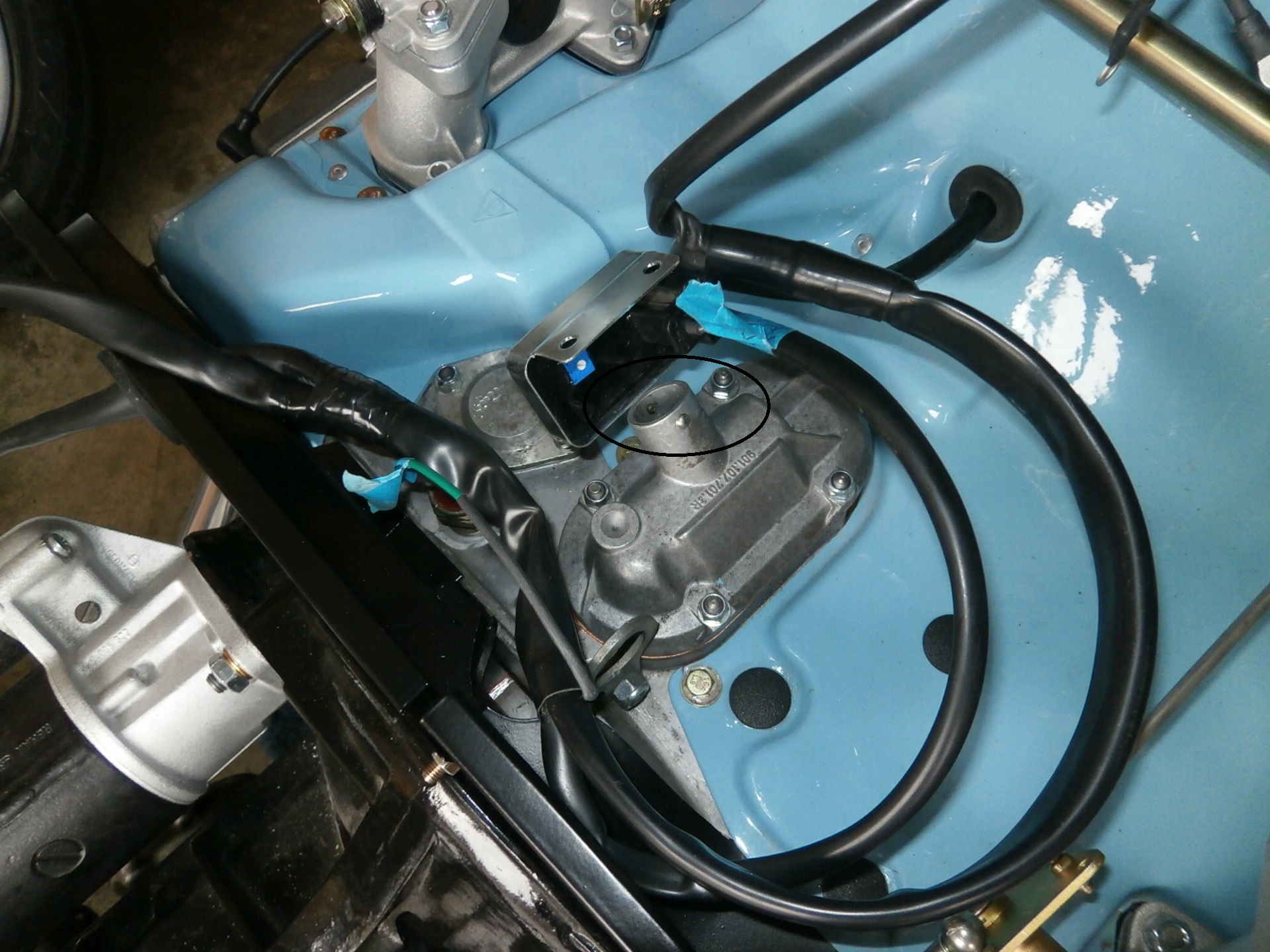

What's the best way to vent the case on the 3.0? I know there's a pipe coming out of the top of the engine, but what should I be connecting it to?

You can get colored heater hose cheap on ebay. This is what I'm using engine to oil tank. Then tank into a Gatorade bottle like Andy.

Heater hose isn't rated for oil vapor, especially for heated oil vapor.

SirAndy   The case vent goes straight to the oil tank: http...   Mar 4 2015, 11:43 AM

PanelBilly   Originally I was just planning to clamp the breath...   Mar 4 2015, 04:49 PM
jd74914   Yes, I would run it to the intake or a catch can. ...   Mar 4 2015, 05:14 PM
