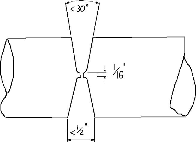

https://www.youtube.com/watch?v=RfnN5Xna2Kc
The journal is prepared by machining a "j" root vee and given a preheat,a few tig passes then cover passes by smaw in an oven.
X-ray quality welds,like for pressure vessels,it's a 2"bar of steel that's highly stressed by the torsional loads.
The Brazilian said the builder had cast a crank for the engine in malleable iron,a nodular pour was possible then,in Brazil.

I've done some aluminum castings at home, I built a propane fueled furnace years ago. The added heat of cast iron scares me a little!
