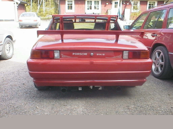

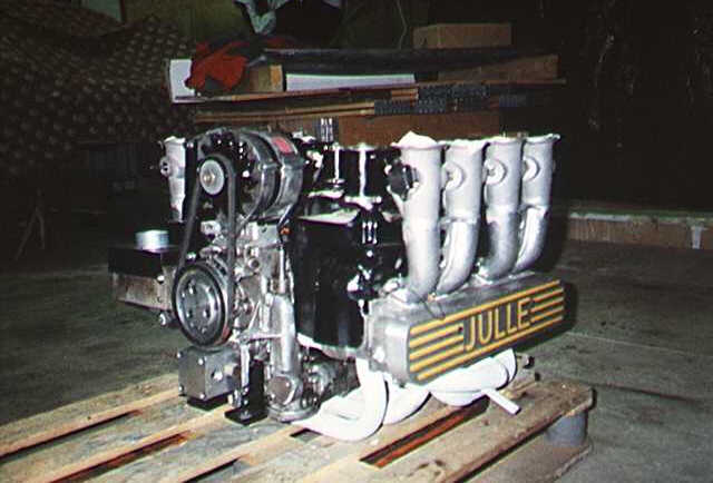

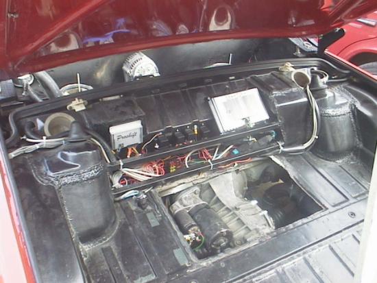

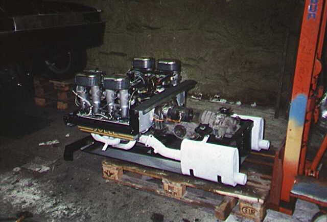

I found more pictures of the Lind Type IV flat 8 motor and it appears he stuck one into a 914!
Notice "8" on the rear of the car and the rear trunk modified for clearance for the air cleaners.
https://www.youtube.com/watch?v=2GpMGPUMyXE
https://www.youtube.com/watch?v=S4kxqwUP1Q0
I found a thread on another air cooled forum with Jake Raby looking into buying one of these motors, I guess they wanted way too much $$ for him to justify doing it.
