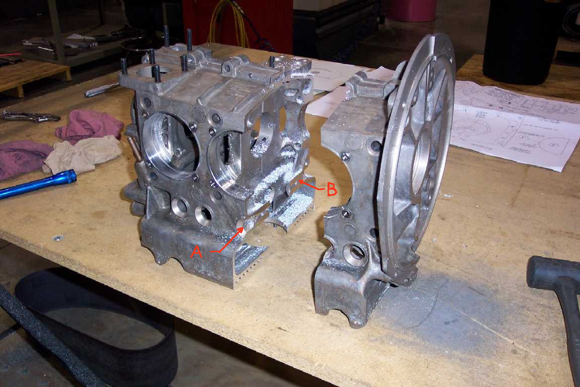

Before you cut: (IMG:style_emoticons/default/biggrin.gif)
Leave excess material for finishing weld prep on both sides of crankcase.
Prepare hollow steel shafts to locate both cam and crankshaft bores +.0005/-0.0002",longitudinal spacing can be accomplished by using case thru-bolts or cylinder spigots.
This Type 1 case has been cut through the lifter bores,not good.
The type 4 case must be cut to avoid critical areas and to facilitate ease of welding.
The Corvair case has symmetrical attributes and a flat milled open top that allows reinforcement plates or a cam carrier to be attached.
A great deal of thought and mapping must be done to attempt a +/-0.003 weldment,preheating and inert gas atmosphere enclosure to ensure top quality welds and alignment.
An adventure in engine building,not mere assembly.
