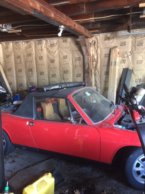

AndyB   Ok so much has happened since my last post. I went...   Apr 24 2015, 06:48 PM
AndyB   The passenger long Drivers long   Apr 24 2015, 06:58 PM
AndyB   Last time it was on the road.   Apr 24 2015, 06:59 PM
AndyB   Don't do it Mark <_<   Apr 24 2015, 07:01 PM
76-914   This is donor car or your Suby conversion car?   Apr 24 2015, 09:20 PM
AndyB   This would be the conversion car. It was a tough c...   Apr 25 2015, 04:39 AM
