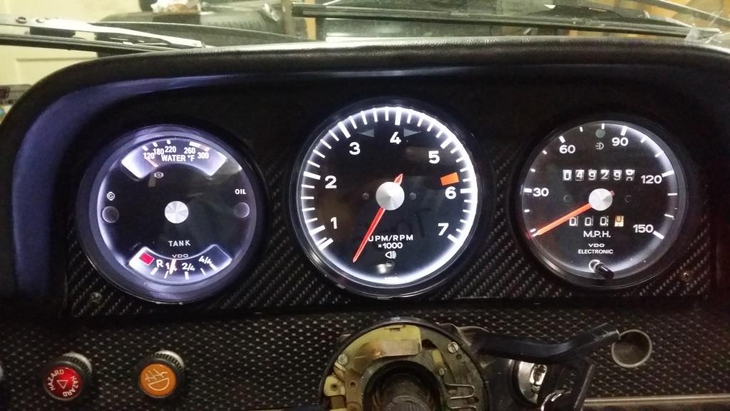

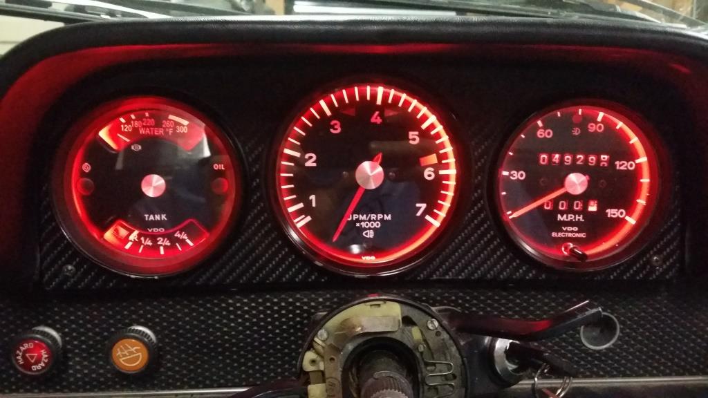

I wanted to keep the stock gauges on my car, just upgraded them and am really pleased with how it turned out! Gauges turn red as a shift light, when the gas is low, and when the headlights are left on!

AndyB   I am going to run the Subaru instruments on my car...   Mar 12 2015, 01:29 PM
Amenson   I am going to run the Subaru instruments on my ca...   Mar 12 2015, 01:55 PM
R_u_dd   I am going to run the Subaru instruments on my c...   Mar 12 2015, 06:42 PM
rnellums   I wanted to keep the stock gauges on my car, just ...   Mar 12 2015, 07:54 PM
914forme   Yep I love this idea, I would also like to add...   Apr 3 2015, 05:38 PM
AndyB   How did you do that? Those are incredible.   Mar 22 2015, 02:16 PM

rnellums   How did you do that? Those are incredible. Send...   Mar 22 2015, 08:41 PM

rnellums   Yep I love this idea, I would also like to ad...   Apr 3 2015, 11:50 PM
mgp4591   Thanks for the kind words but I am FAR from having...   Apr 4 2015, 01:55 PM
