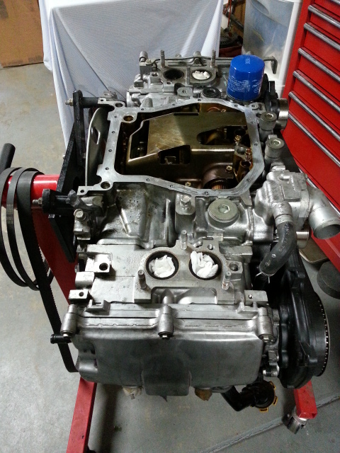

So I started to collect all the necessary conversion parts. I have the Coldwater 914 cradle, axles, shift linkage, ect. I also picked up a 5 speed Subaru transmission and clutch (thanks Scotty!) My 2007 Subaru wagon became the engine donor (EJ253 173 hp @ 5600 rpm, 166 ft·lbf torque @ 4000 rpm). (IMG:style_emoticons/default/aktion035.gif) After spending some time on the Outfront Motorsports web site I ended up with a Stinger ECU, wiring harness, throttle body and mid engine oil pan. I think I have almost everything needed with the exception of a radiator.

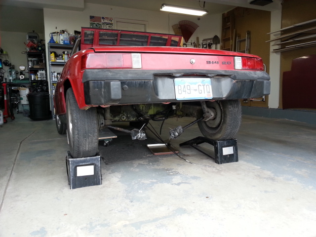

And so it starts. On the first weekend of this month a crew of Colorado 914 guys came over to help remove the stock engine and transmission from my 74. Scotty made sure all the neighbors were awake and taking notice when he arrived in his awesome white 914. (IMG:style_emoticons/default/happy11.gif) It is never a bad time when you get a group of 914 guys together. (IMG:style_emoticons/default/biggrin.gif)
This weekend will be spent replacing the head gaskets on the EJ253 and installing the oil pan from Outfront Motorsports. I am hoping to flip the intake manifold with the use of some Grimmspeed phonolic spacers. I am unsure if this is possible but I am going to find out soon.
