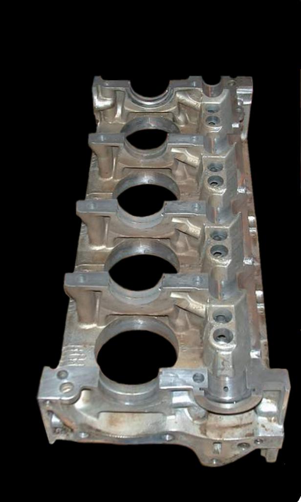

Bulletproof cases in wrought material,pricey,tho just what you need for a big bore short stroke flat 8.
A high level of customization is possible with this approach,a one off custom.
What the Corvair-8 case looks like in gimp.Pretty huh?A simple approach.Cut and weld.

veekry9   Before you cut: :D Leave excess material for fi...   Mar 10 2015, 04:13 AM
veekry9   Corvair cases tig welded to an 8 cylinder config...   Mar 10 2015, 06:26 AM
