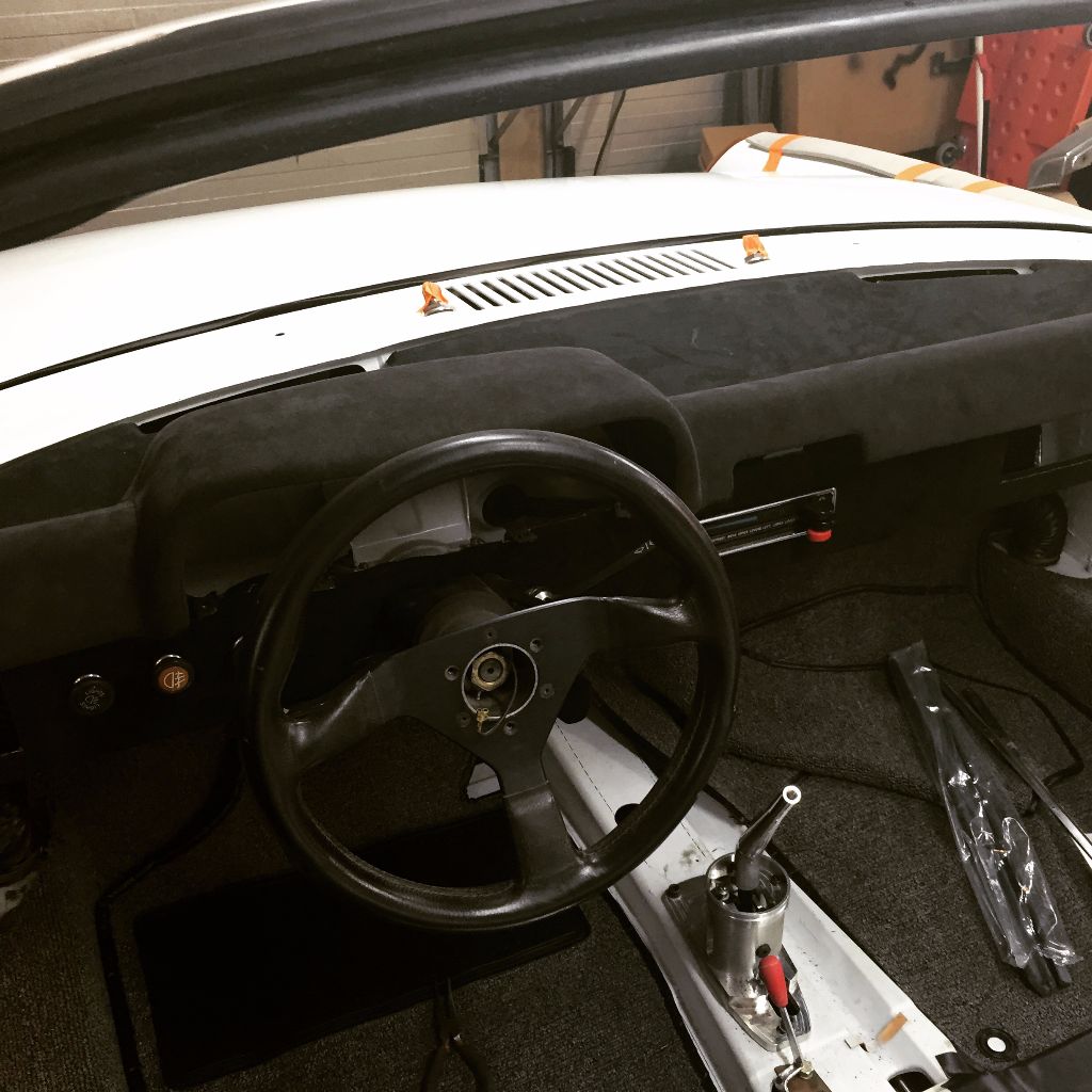

(IMG:http://www.914world.com/bbs2/uploads_offsite/matsgarage.com-15176-1427261358.1.jpg)
Got my dash back from the upholsterer....sooo smooth!

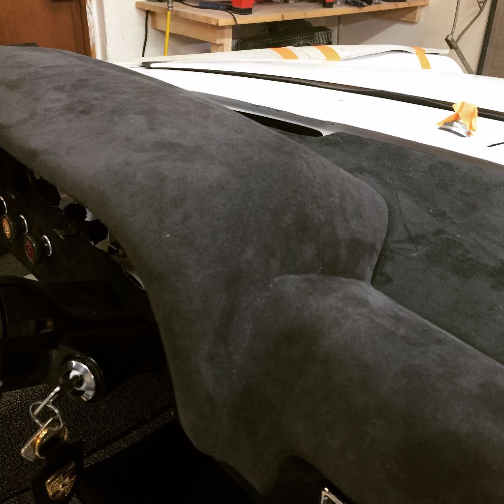

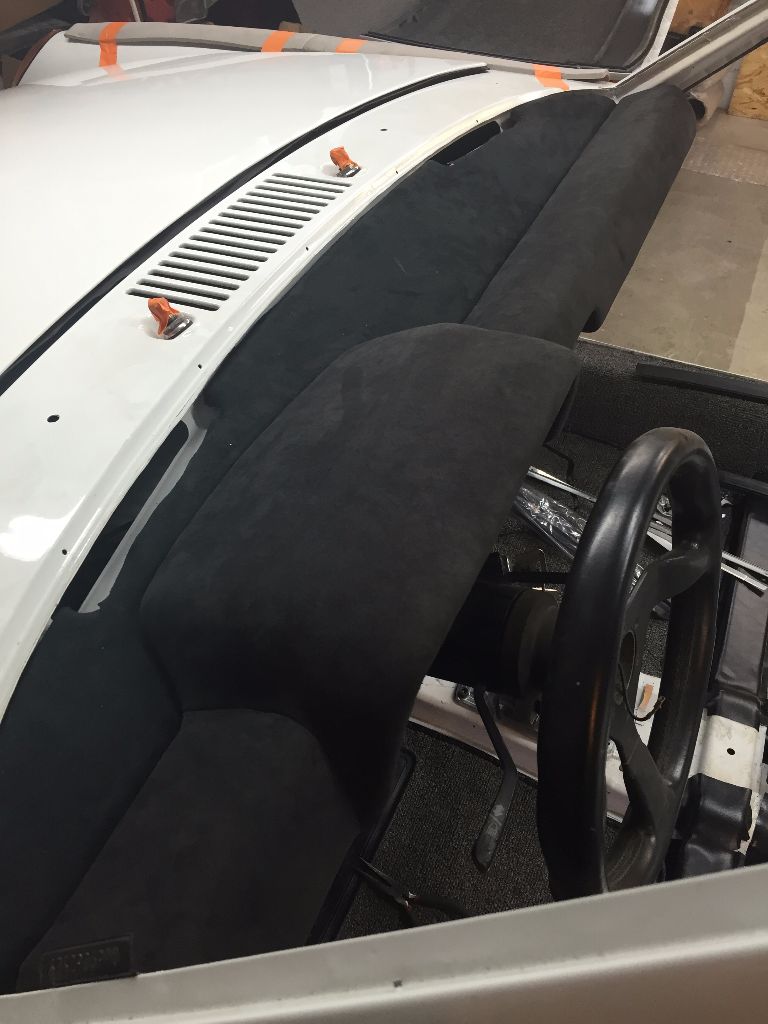

(IMG:http://www.914world.com/bbs2/uploads_offsite/matsgarage.com-15176-1427261360.2.jpg)
(IMG:http://www.914world.com/bbs2/uploads_offsite/matsgarage.com-15176-1427261361.3.jpg)
Closeup, he had to lay one seam to either side of the bulge and one across the top but it turned out great. He also did the lower piece but I didnt get any pics of that.

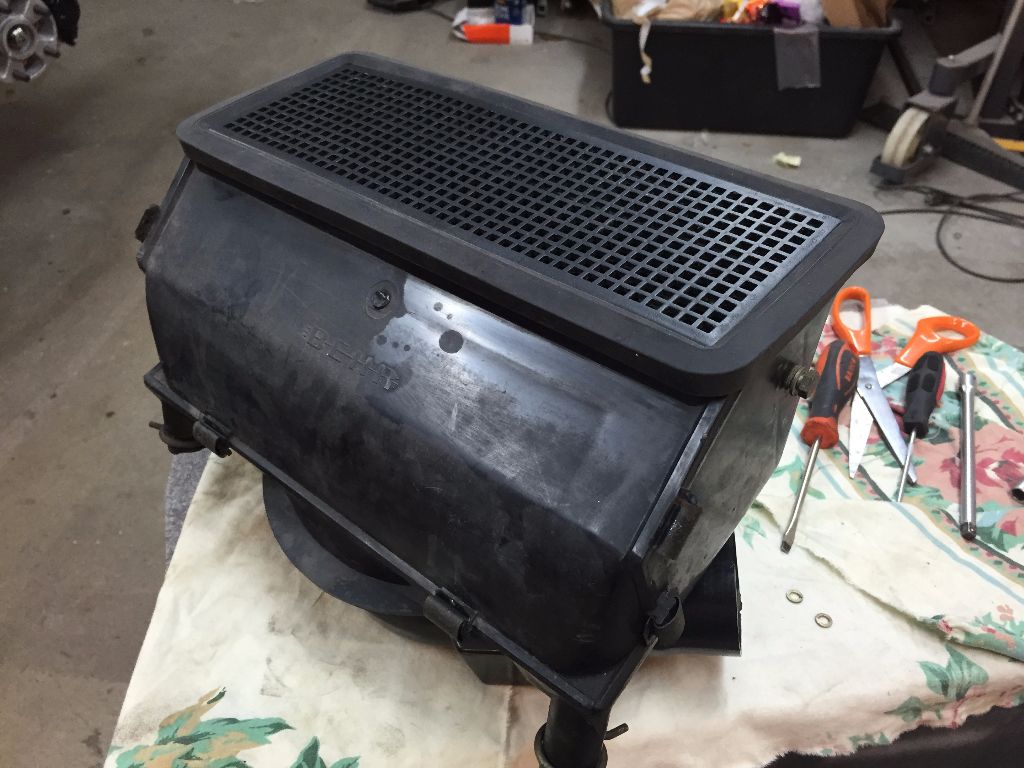

(IMG:http://www.914world.com/bbs2/uploads_offsite/matsgarage.com-15176-1427261362.4.jpg)
Also got my fresh air box back together. Used some 15x5 mm straight foam cell adhesive strips to seal the motor against the housing and the rest of the seals are from 914Rubber's airbox rebuild kit. Not sure why I cant get the box to clean up, annoying with one half looking ok and the other half looking dirty.
