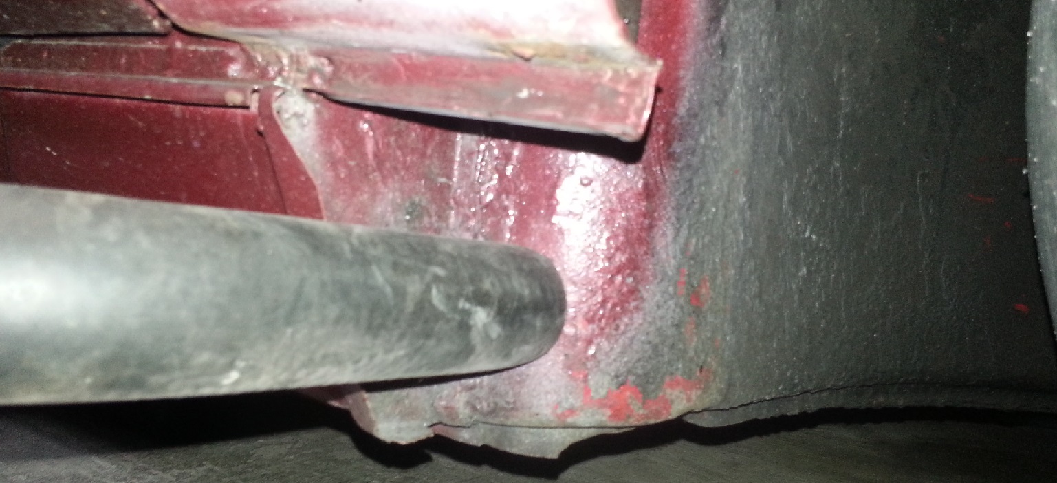

Hi Andy,
Something I have been thinking of for a long time is to move my coolant lines from under the car to under the rocker cover. The thought is to drill a 1.5 ~ 1.7 hole thru to the inside. See photo. I am not sure how large of a hole I can get away with before I hit the heater tube? Anyone have a dissected long? Then the hole would have to be filled with a tube welded onside and out.
