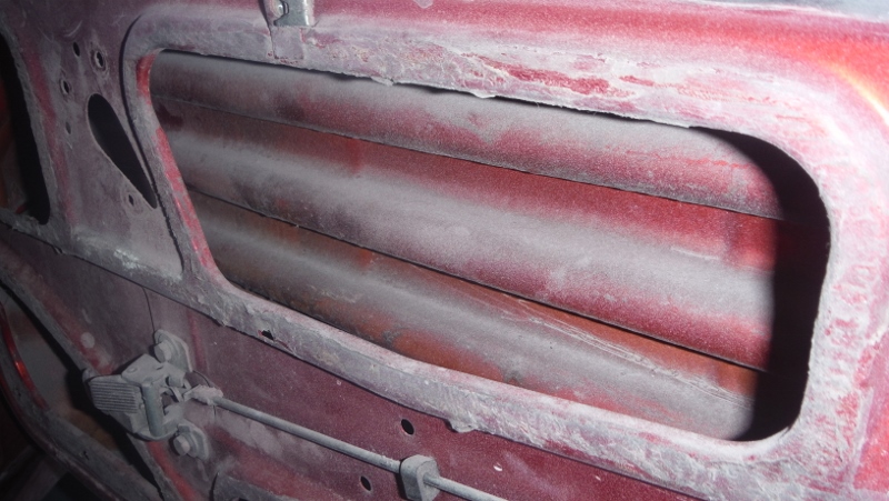

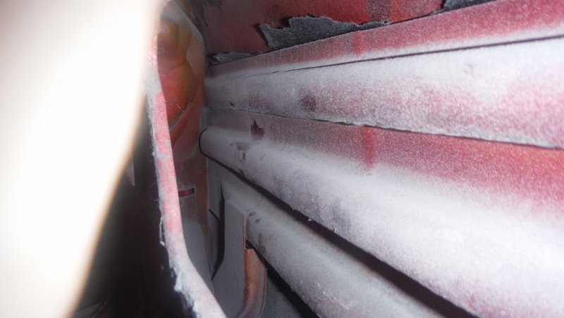

(IMG:style_emoticons/default/dead horse.gif) These are the doors on my '70 six. I assume they are not original since they have crash bars yet they have original signal orange paint. These are the crash bars pictured. Yes? I also have early regulators ( thanks for the pictures Dave) I'm looking to replace drivers door so question is... do early regulators fit in late doors? I'm thinking yes unless these are hybrid or modified? (IMG:style_emoticons/default/confused24.gif)

altitude411   :deadhorse: These are the doors on my '70 si...   Apr 1 2015, 11:06 AM
SirAndy   do early regulators fit in late doors? Nope, compl...   Apr 1 2015, 03:32 PM

altitude411   So these aren't late doors? Those are impact b...   Apr 1 2015, 03:45 PM
SirAndy   So these aren't late doors? They are LATE doo...   Apr 1 2015, 03:54 PM
altitude411   Humm... I pulled the regulators and they are cable...   Apr 1 2015, 03:59 PM
SirAndy   Humm... I pulled the regulators and they are cable...   Apr 1 2015, 04:26 PM
altitude411   I completely understand & agree w/everything y...   Apr 1 2015, 04:44 PM
Olympic 1.7   Maybe someone put the early inner panels on later ...   Apr 1 2015, 05:46 PM
altitude411   Oly 1.7; I would think it would be much easier to ...   Apr 2 2015, 01:00 AM
