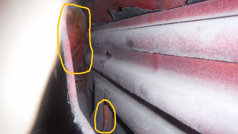

So these aren't late doors? Those are impact bars aren't they? I'm beyond confused. (IMG:style_emoticons/default/headbang.gif) But, I do know what signal orange is and there is signal orange hiding behind the re spray & grime...I know it's tough to see in the photo's.

QUOTE(altitude411 @ Apr 1 2015, 02:45 PM) *
They are LATE doors with LATE impact beams and mounting for a LATE window mechanism.
Look at Dave's images above to see what an early door looks like ...
