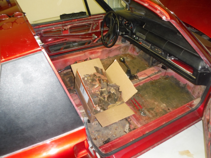

Oly 1.7; I would think it would be much easier to just source the other regulator.
Regardless, I know nobody gives a shit at this point, but this is the best pic I could find of my assembled door. If you zoom in you can see early (cable) regulator on a obviously late door.
* also note the highly sought after triple crack dash*
