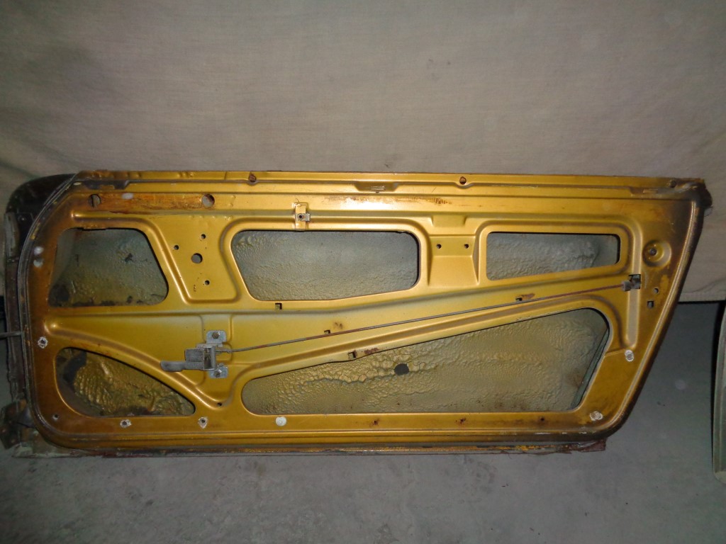

altitude411   :deadhorse: These are the doors on my '70 si...   Apr 1 2015, 11:06 AM
SirAndy   do early regulators fit in late doors? Nope, compl...   Apr 1 2015, 03:32 PM
whatabout1   My '73 has bars and late regulators. The int...   Apr 1 2015, 11:50 AM
altitude411   So these aren't late doors? Those are impact b...   Apr 1 2015, 03:45 PM
SirAndy   So these aren't late doors? They are LATE doo...   Apr 1 2015, 03:54 PM

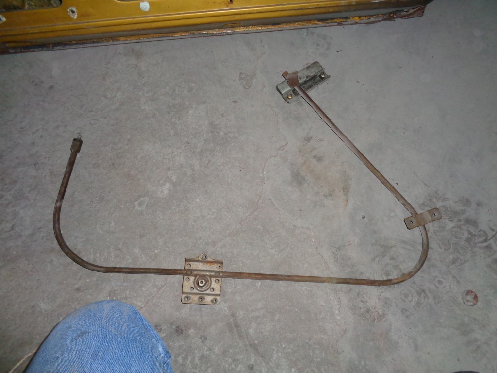

altitude411   Humm... I pulled the regulators and they are cable...   Apr 1 2015, 03:59 PM
SirAndy   Humm... I pulled the regulators and they are cable...   Apr 1 2015, 04:26 PM
altitude411   I completely understand & agree w/everything y...   Apr 1 2015, 04:44 PM

scotty b   early door, early regulator. ( Cairo's - 6 )   Apr 2 2015, 08:53 AM
scotty b   late door ( late 73 on ) and Early door together. ...   Apr 2 2015, 08:54 AM
scotty b   I also have some early 73 doors in storage if anyo...   Apr 2 2015, 08:56 AM
altitude411   hair trigger...   Apr 2 2015, 09:14 AM
altitude411   Thanks for the pics Scotty. So an early regulator...   Apr 2 2015, 09:19 AM
altitude411   Ok, to round out my learning curve.... :korijo: ...   Apr 2 2015, 09:23 AM
