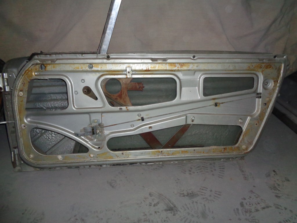

late door ( late 73 on ) and Early door together.
I'll try to remember to get a pic of a late regulator next time I have one out

scotty b   early door, early regulator. ( Cairo's - 6 )   Apr 2 2015, 08:53 AM

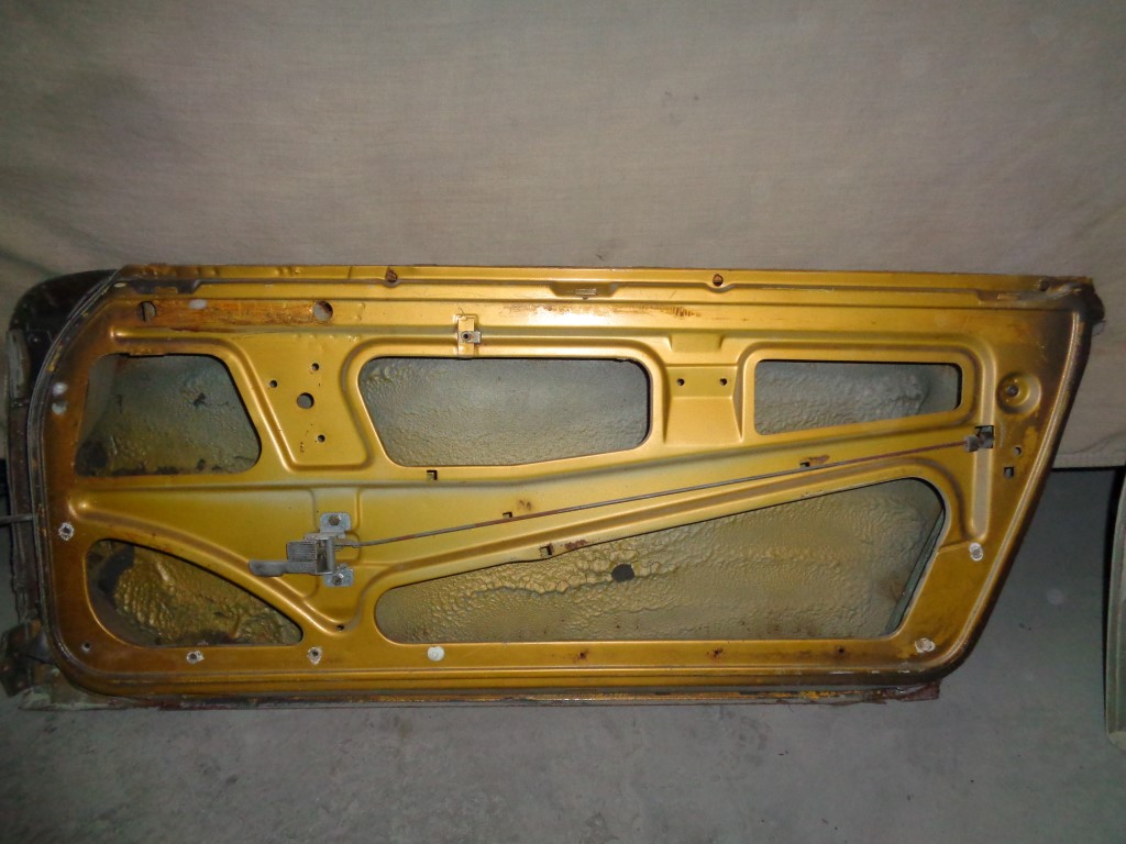

scotty b   late door ( late 73 on ) and Early door together. ...   Apr 2 2015, 08:54 AM
scotty b   I also have some early 73 doors in storage if anyo...   Apr 2 2015, 08:56 AM

altitude411   Thanks for the pics Scotty. So an early regulator...   Apr 2 2015, 09:19 AM
altitude411   Ok, to round out my learning curve.... :korijo: ...   Apr 2 2015, 09:23 AM
