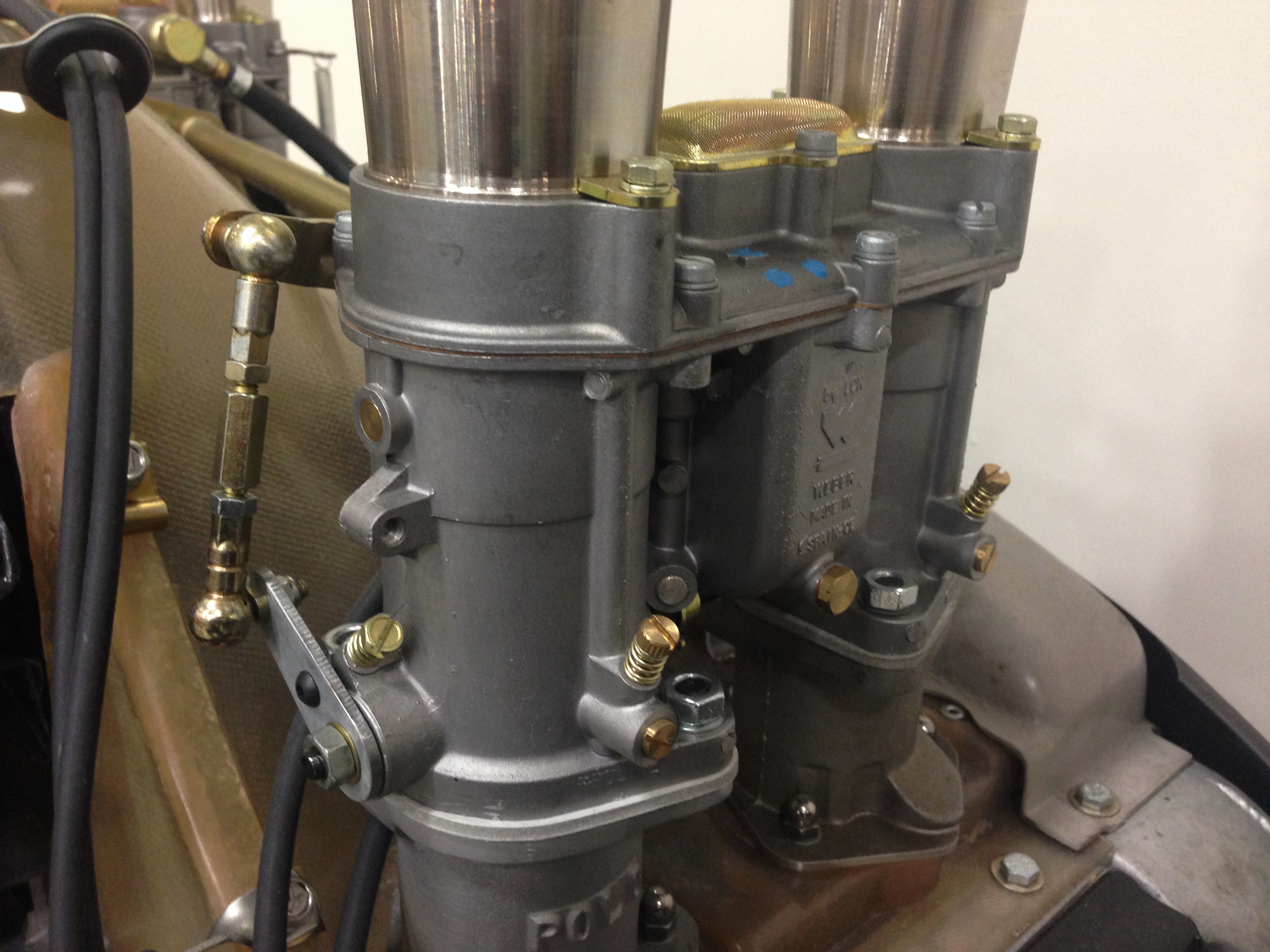

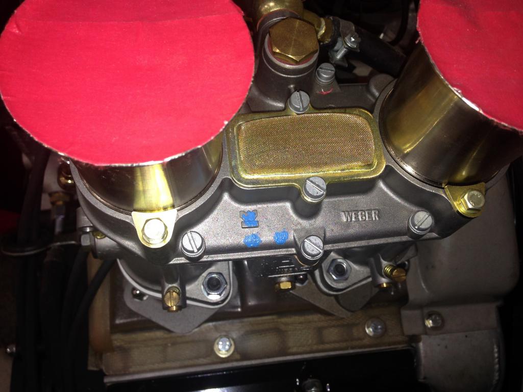

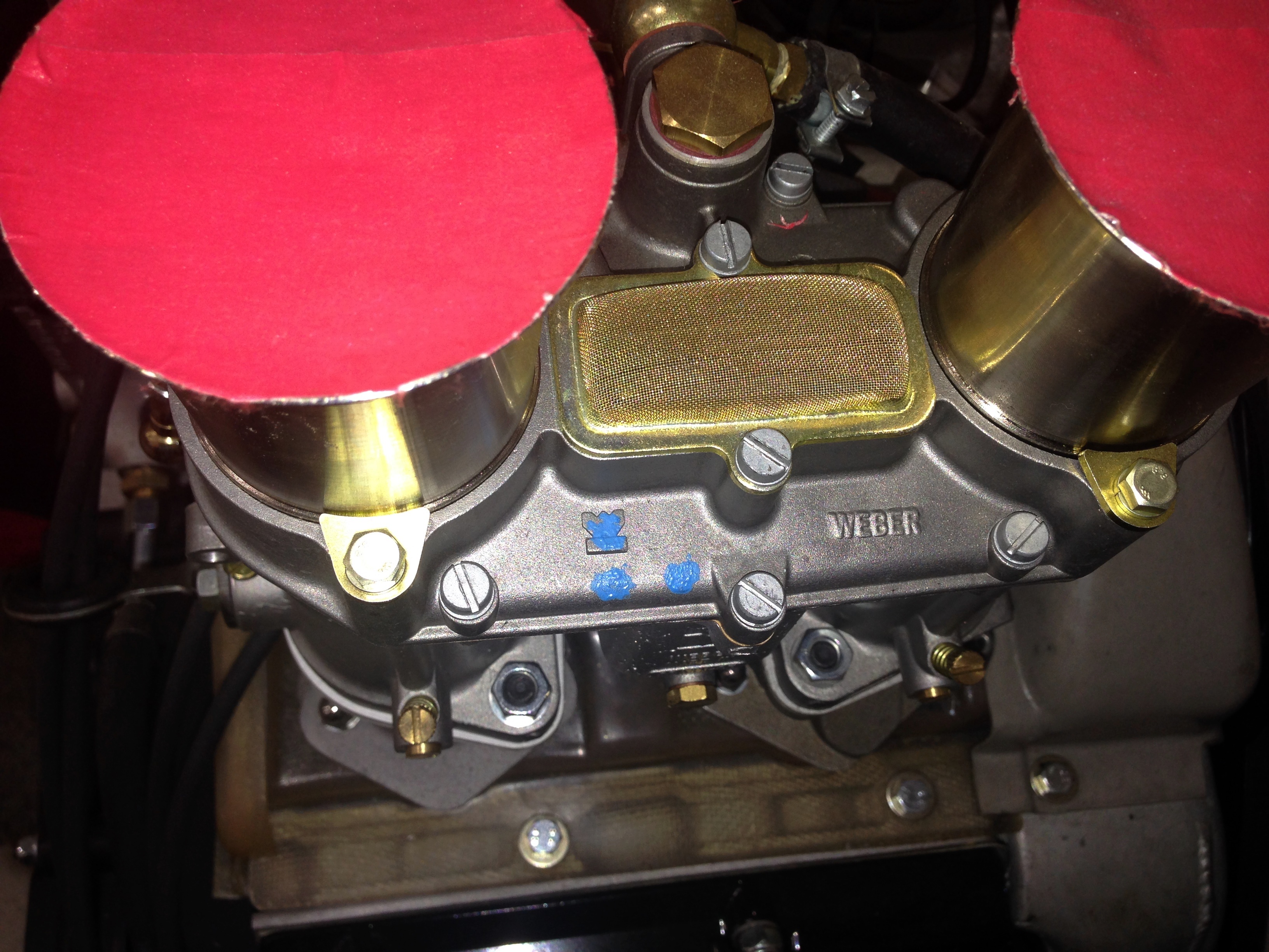

Following up on my emulsion tube issue this week:
These carbs were purchased from Webercarbsdirect.com and were represented as genuine Webers.
They are not. They are Chinese knock-offs.
The retailer refuses to take them back.
You've been warned!
Do everyone a favor and spread this around to help others from getting screwed.
