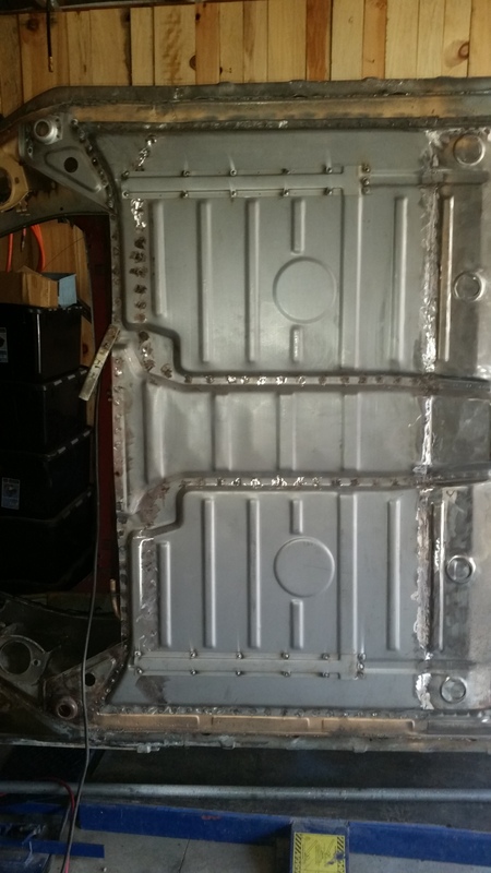

OK, at long last, an update. I finished the underside of the floor.

trojanhorsepower   OK, at long last, an update. I finished the under...   Apr 19 2015, 07:09 PM
