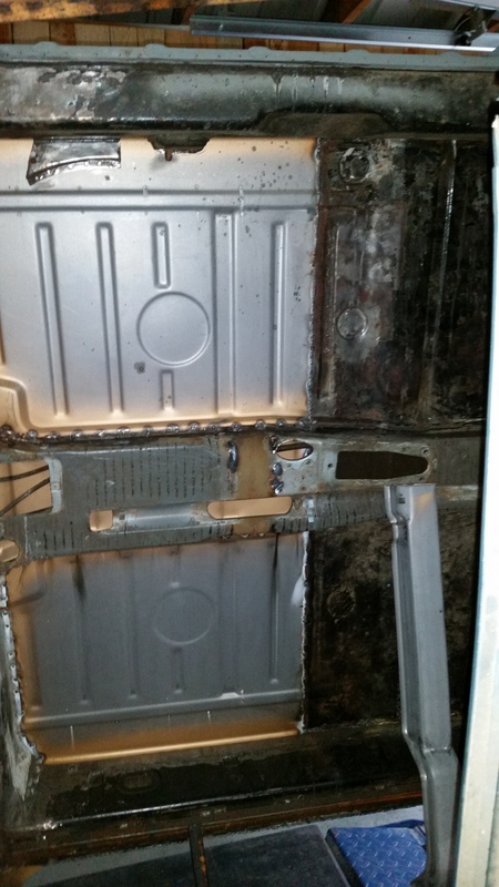

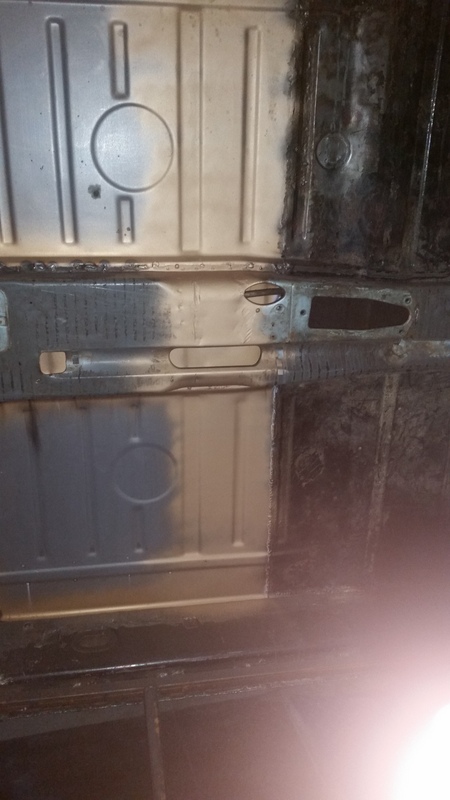

trojanhorsepower   Finally an update. Got the cross member welded in...   Jul 12 2015, 01:31 PM
trojanhorsepower   Also got the little seat adjuster bracket that wel...   Jul 12 2015, 01:34 PM

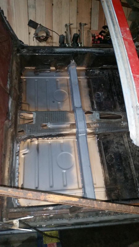

trojanhorsepower   Thanks, glad you are enjoying it. The center tunne...   Jul 12 2015, 05:47 PM
trojanhorsepower   After Okteenerfest inspiration and some mild chast...   Sep 20 2015, 04:53 PM
