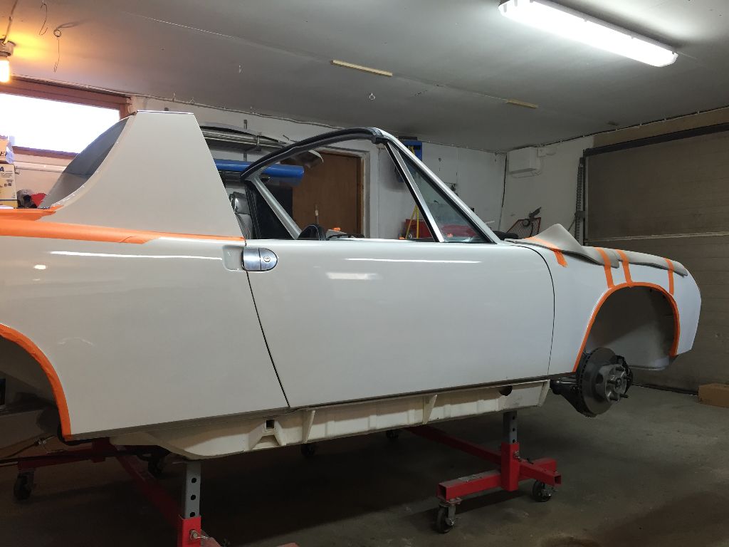

Doors have been added, panel gaps are ok on the passenger side and slightly off on the drivers side, will just have to live with that or get a less molested driver side door.

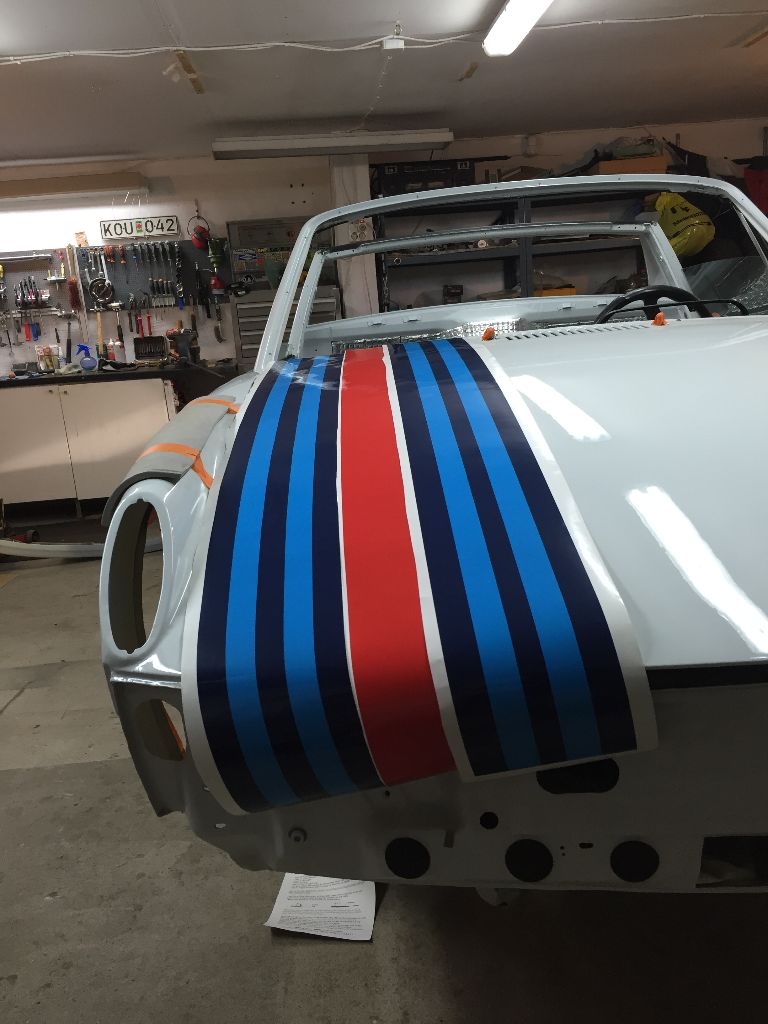

And I can reveal a bit about how the car will be decorated later on... (IMG:style_emoticons/default/blink.gif)

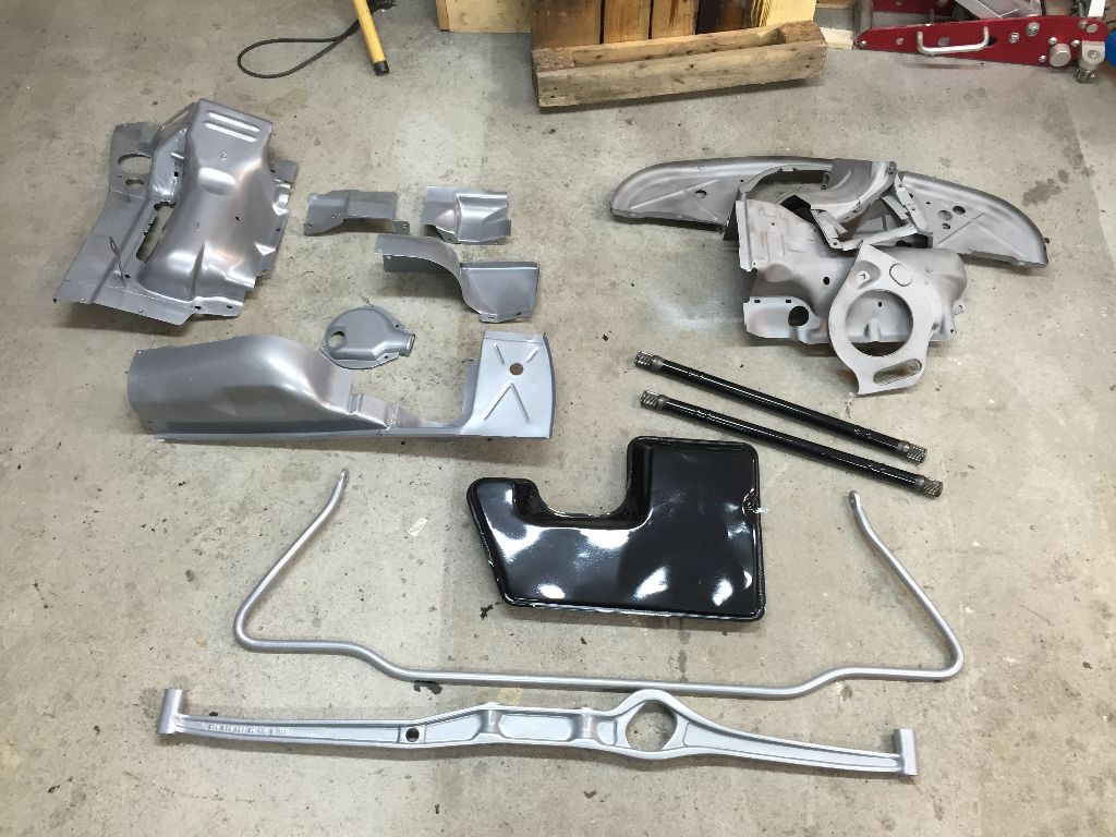

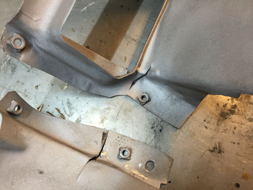

More parts back from powdercoat, the pile on the right failed pre paint inspection and needs some attention
(IMG:http://www.914world.com/bbs2/uploads_offsite/matsgarage.com-15176-1429591313.3.jpg)
...there were cracks....

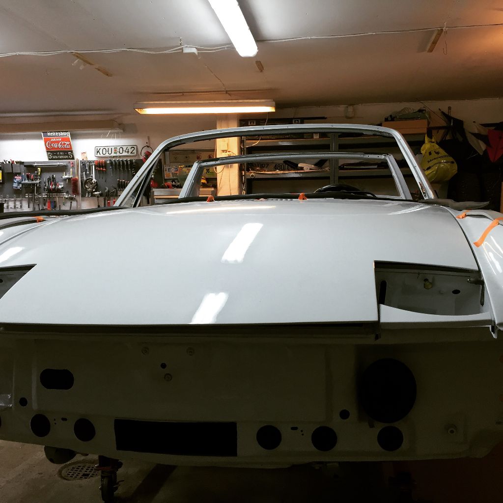

Trying to align the hood, the new front bulkhead seal seems to be too tall for the
GRP hood as it make the middle of it bulge up out of alignment.... (IMG:style_emoticons/default/sad.gif)

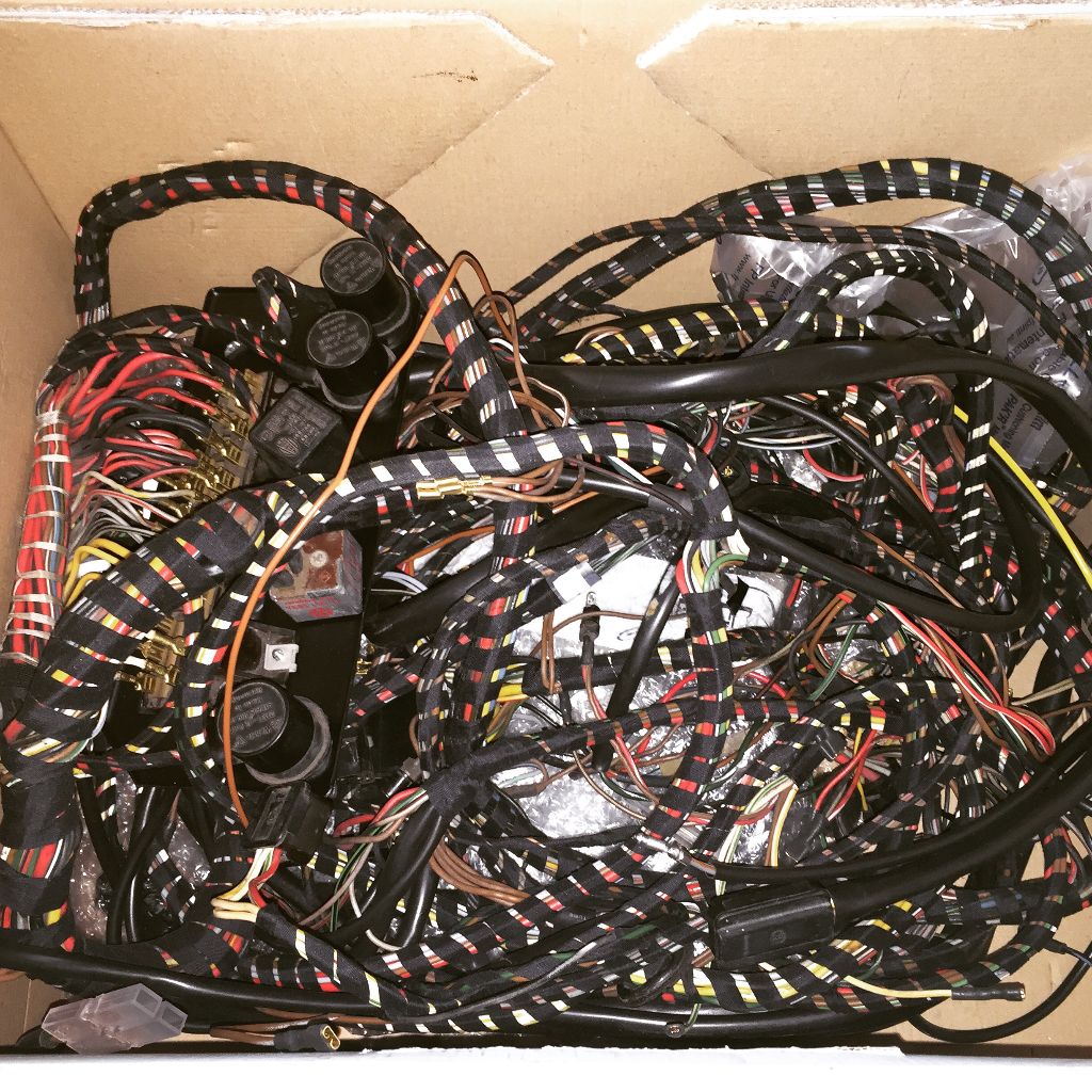

The blackstriped electrical snake...

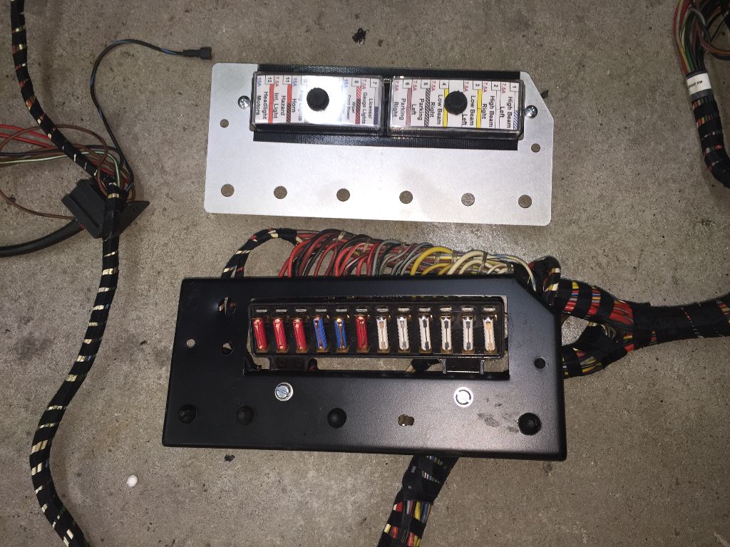

New fuse panel (yes it was painted black before it was installed)

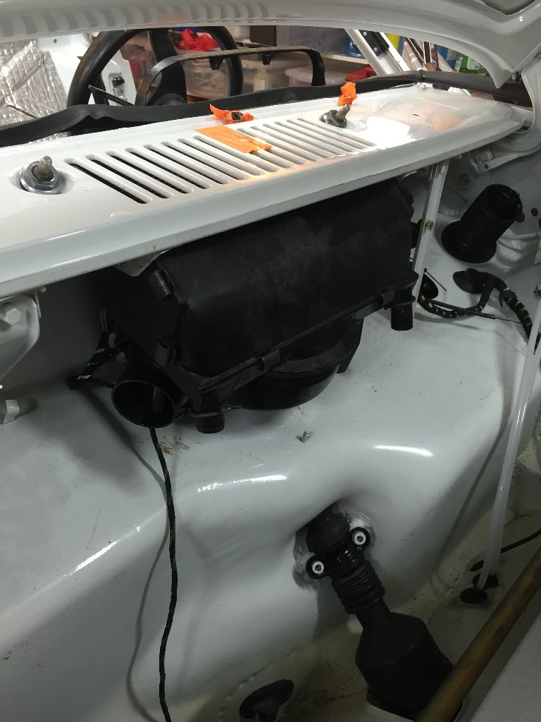

Airbox went back in after the harness slithered into place.

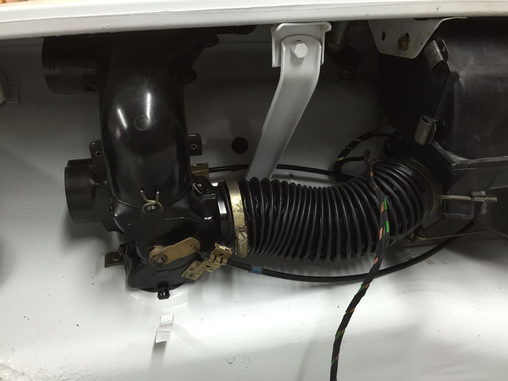

Along with the flapper valves and hoses.

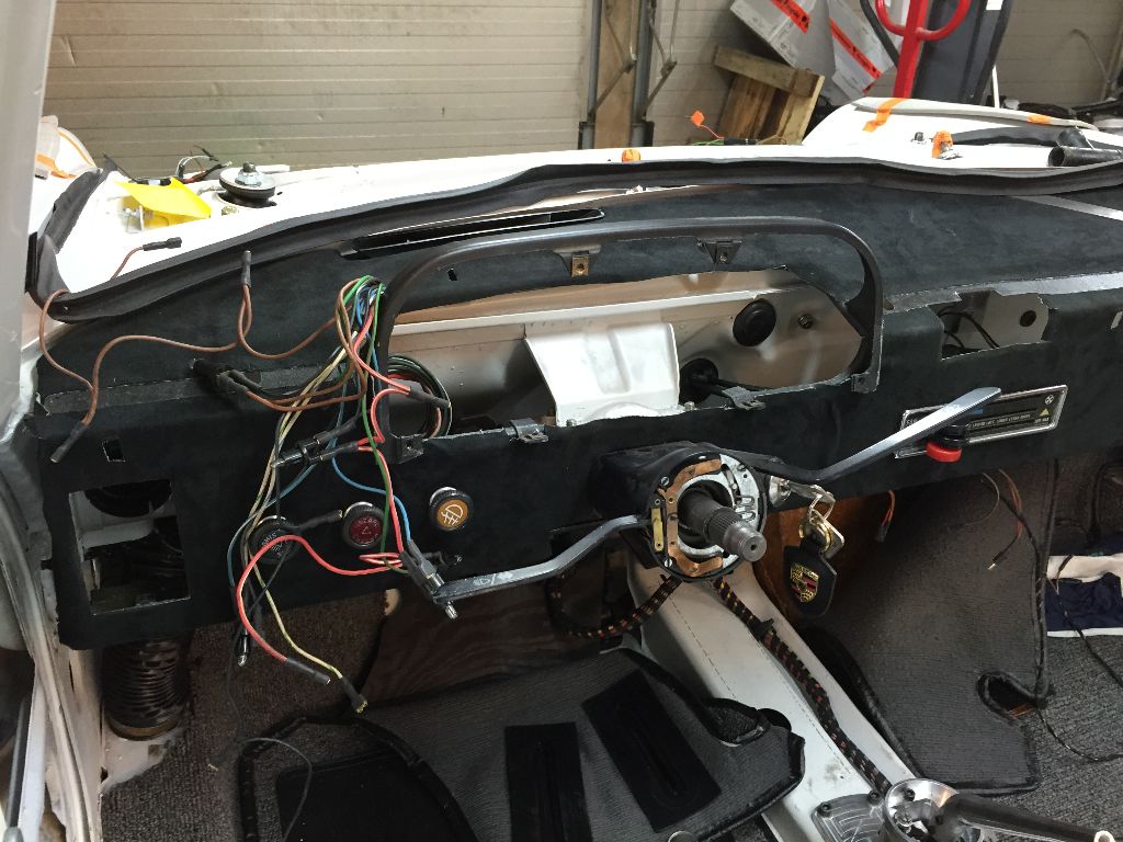

Cables everywhere...
(IMG:http://www.914world.com/bbs2/uploads_offsite/matsgarage.com-15176-1429591319.8.jpg)

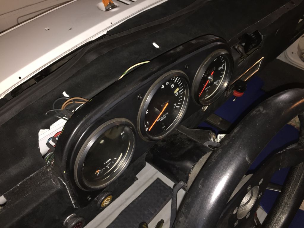

Slowly coming together, the plastic face on my left gauge has a defect in it, needs to be sorted at a later date.
(IMG:http://www.914world.com/bbs2/uploads_offsite/matsgarage.com-15176-1429591320.9.jpg)

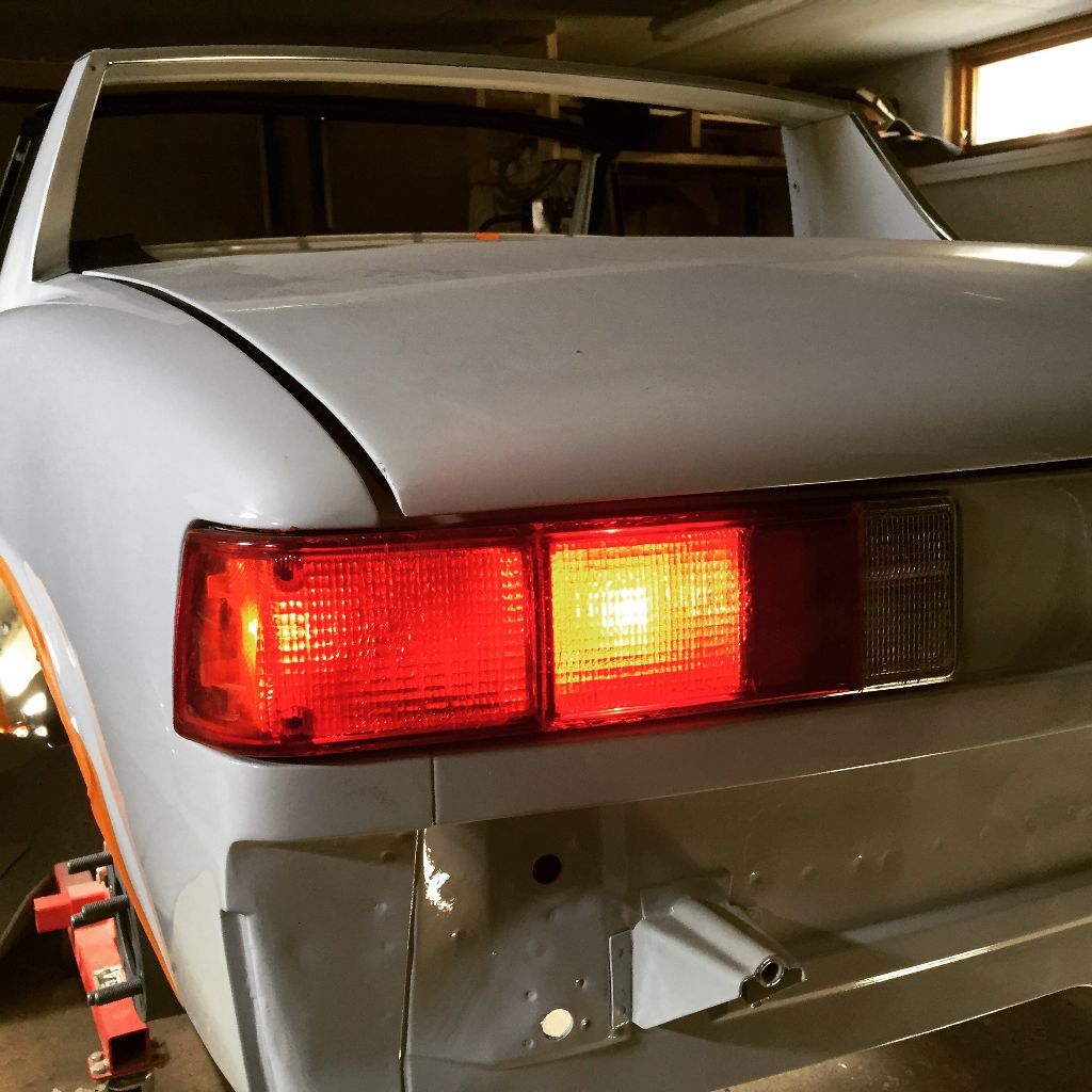

And on sunday I tried to release the magical smoke, I failed. (IMG:style_emoticons/default/biggrin.gif)
Still working on installing all the electrical stuff back into the car but it felt like a major
step to have the lights light up again.

pete000   Love the dash, how did they do that?   May 27 2015, 04:36 PM
falcor75   I'm not quite sure how he did it but I've ...   May 28 2015, 05:32 AM
falcor75   Yesterday I had some help to start laying down ...   May 31 2015, 02:32 PM
falcor75   And todays work. :)   May 31 2015, 02:34 PM
Mikey914   Looking real good. I love the look of fresh rubber...   May 31 2015, 04:02 PM
falcor75   Looking real good. I love the look of fresh rubbe...   May 31 2015, 11:05 PM
falcor75   Got a package in the mail with some long awaite...   Jun 2 2015, 11:10 PM
thieuster   Nice! But what's with the other edges of t...   Jun 2 2015, 11:15 PM
falcor75   There's some minor burrs from the lasercutting...   Jun 2 2015, 11:42 PM
