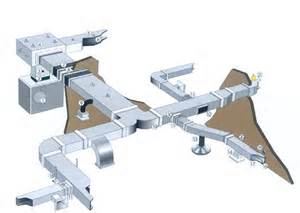

QUOTE(worn @ Apr 22 2015, 10:03 AM) *
QUOTE(Elliot Cannon @ Apr 13 2015, 11:12 PM) *
Noticed that one too. Very common though. So much so that they named tape that way.
I think even the HVAC people spell it that way now. (IMG:style_emoticons/default/laugh.gif) It's about time. (IMG:style_emoticons/default/av-943.gif)
