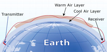

One of my hobbies involves tropospheric ducting (IMG:style_emoticons/default/shades.gif)

There is warm air at the North Pole?
