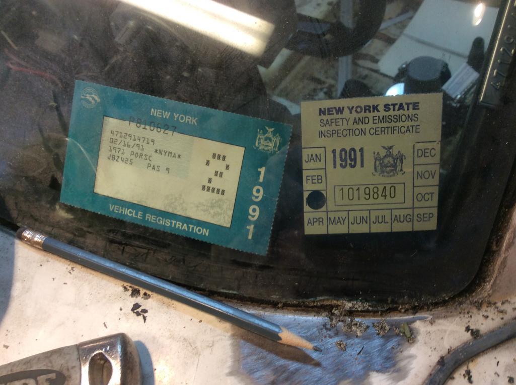

AndyB   Ok so much has happened since my last post. I went...   Apr 24 2015, 06:48 PM
AndyB   The passenger long Drivers long   Apr 24 2015, 06:58 PM
AndyB   Last time it was on the road.   Apr 24 2015, 06:59 PM
AndyB   Don't do it Mark <_<   Apr 24 2015, 07:01 PM
