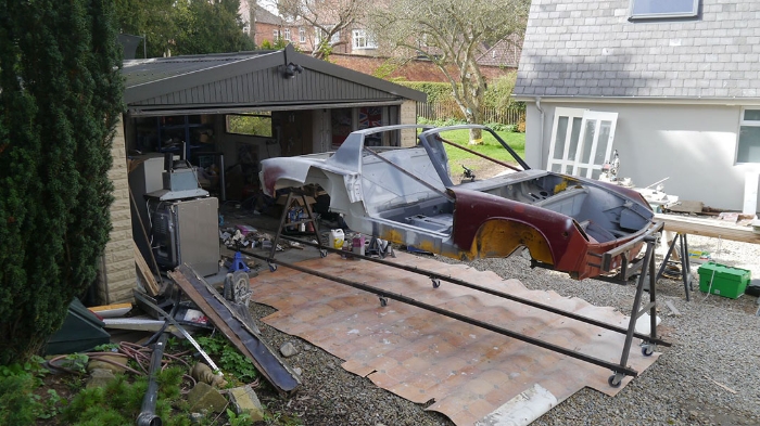

Hi,
I have to move my restoration project about 250 miles on the motorway(highway!) coz I just got a new job and am upping sticks. The tub is on a rotisserie right now, attached at the suspension and gearbox mounts instead of the bumper mounts. I'll probably just bolt a couple of timber planks to the rotisserie frame and use some large pneumatic castors to roll it around and onto a trailer. I'm keen to have the tub bolted to the trolley instead of just strapping it down - to avoid unwanted 'offloading' at high speed! Show me how you've done it…looking for ideas. Thanks. (IMG:http://www.914world.com/bbs2/uploads_offsite/i1235.photobucket.com-13282-1430926995.1.jpg) |

I transported my tub on a flatbed trailer from Germany to Holland, the whole floor section supported the weight. 4 guys can lift it on the flatbed easy enough. No rotisserie of course

Unobtanium-inc The main thing to remember is you can never have t... May 6 2015, 10:09 AM
OllieG
The main thing to remember is you can never have ... May 6 2015, 02:31 PM
cary Ollie,
Do you have a shot (picture) of your rotis... May 7 2015, 08:06 AM
r_towle Tub weighs about 400 lbs. get three friend and tak... May 7 2015, 09:56 AM
PanelBilly I rented a 20' box truck from Penske and used ... May 7 2015, 10:51 AM![]() ![]() |
