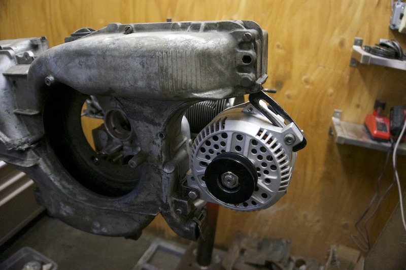

I needed a new alternator for the Turbo 1.7 car and with all of the upgrades I've done I thought I'd look around for a higher amperage unit to install. I know this has been done before, but I wanted something that was a more natural fit. And while I was looking, something with 'modern' technology would be nice.
I found a unit that looked promising and took the leap. It's a built to order, made in the USA unit. It features a built in regulator for a single wire installation, and it's 150 amps (also available in 240 amp! (IMG:style_emoticons/default/ohmy.gif) ).

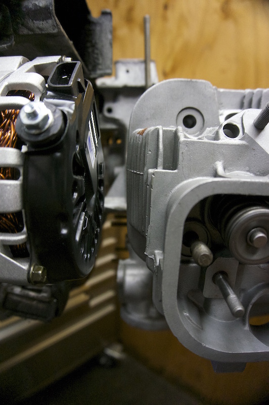

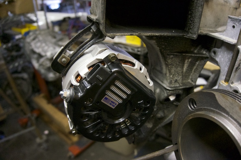

It finally arrived last week and holding it roughly in place nothing jumped out as a major problem, but there were a few tweaks to the housing. So a little trimming of the two mounting points, a bushing to reduce the pivot shaft diameter to 8mm, and drilling the top mount to 8mm it fits perfectly. Works just like an original unit, has MORE clearance than a stock unit although it weighs quite a bit more. (IMG:style_emoticons/default/wink.gif)
I want to get this installed in my car before I make any promises, but this is looking like a REALLY easy upgrade. NO MORE VOLTAGE REGULATOR!!! (IMG:style_emoticons/default/aktion035.gif)

McMark   The alternator is sold just as it's shown. I...   Apr 13 2015, 05:43 PM
McMark   Looked and theres a fan inside. :thumbsup:   Apr 13 2015, 11:51 PM

euro911   Looks good, Mark. Will the OEM alternator tin fit ...   Apr 14 2015, 02:17 AM
McMark   Just heard back that the alternator is the correc...   Apr 22 2015, 10:53 AM
