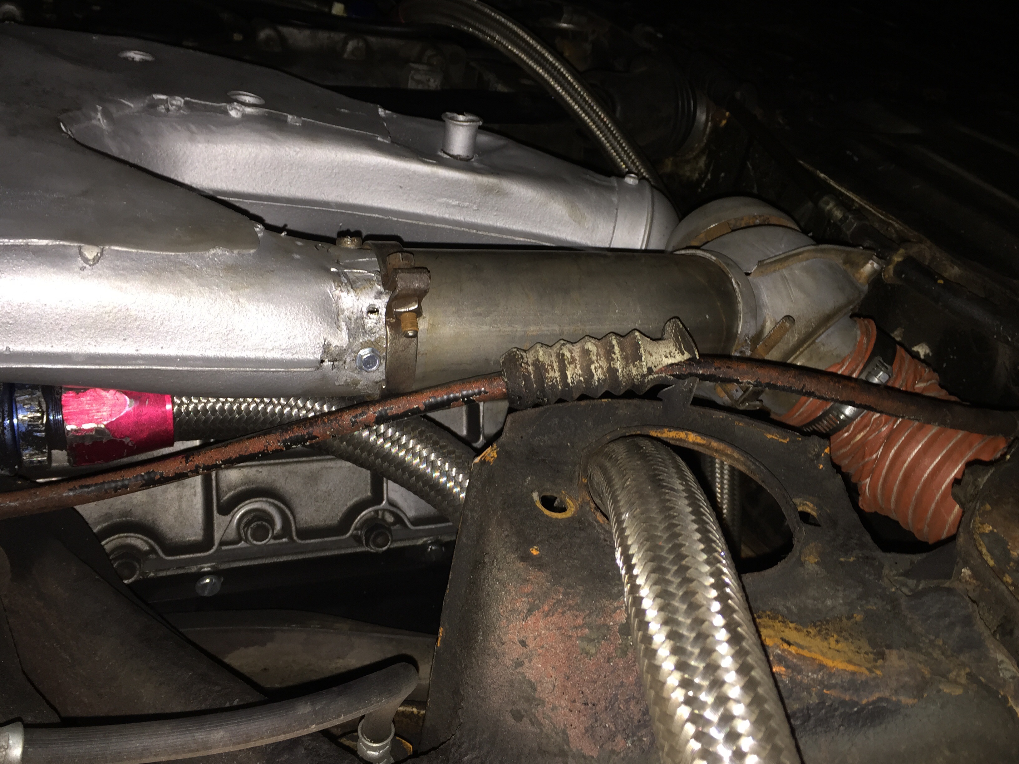

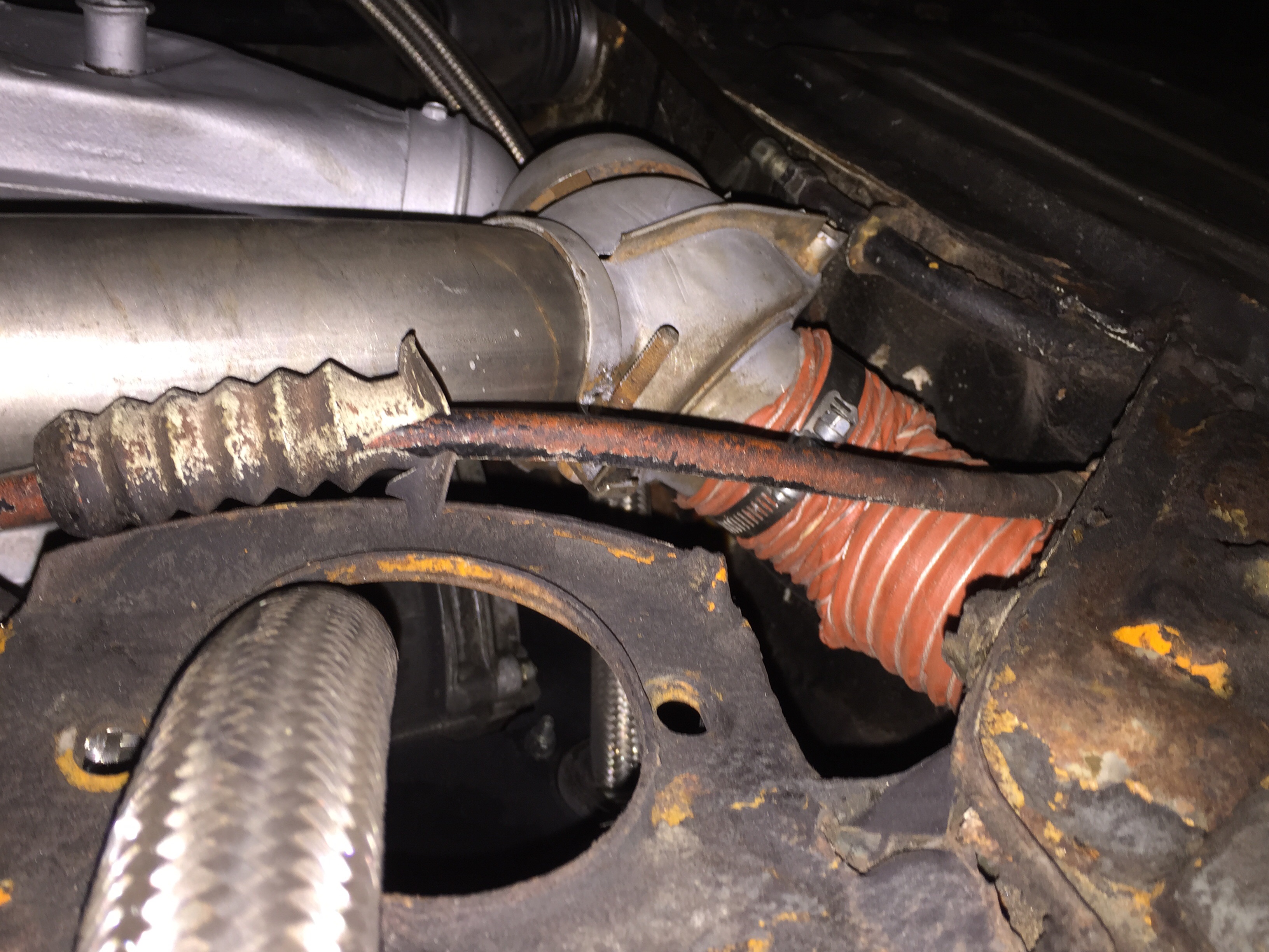

I drove the car for an hr and no luck .
I unhook the Jose drom the flappers and blow air from my leaf blower and I got plenty of air from the vent .
The flappers could use some adjustments but they are more than half wAy open
Here is the setup .

GeorgeRud   The engine fan is absolutely necessary to push air...   May 18 2015, 07:18 AM
914itis   The engine fan is absolutely necessary to push ai...   May 18 2015, 07:32 AM
914itis   Thanks .   May 18 2015, 09:38 AM
rgalla9146   Paul No need for J pipes on a 6 Engine cooli...   May 18 2015, 09:52 AM
mepstein   I'm pretty sure you want the heat hooked up fo...   May 18 2015, 09:59 AM
euro911   So Paul, do you already have a set of fan duct noz...   May 18 2015, 10:36 AM
914itis   Yes I do. They are currently capped.   May 18 2015, 10:58 AM
mepstein   Yes I do. They are currently capped. Great. Your...   May 18 2015, 12:42 PM
