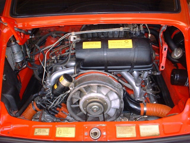

Do you have the hoses from the side of the alternator fan to the HE's?

Mark,
Looking at this picture , does the flex pipe shown attaches to a j pipe as in the T4's or does it go all the way down to the exchangers?.
Thanks

GeorgeRud   The engine fan is absolutely necessary to push air...   May 18 2015, 07:18 AM

rgalla9146   Paul No need for J pipes on a 6 Engine cooli...   May 18 2015, 09:52 AM
mepstein   I'm pretty sure you want the heat hooked up fo...   May 18 2015, 09:59 AM

mepstein   Yes I do. They are currently capped. Great. Your...   May 18 2015, 12:42 PM
