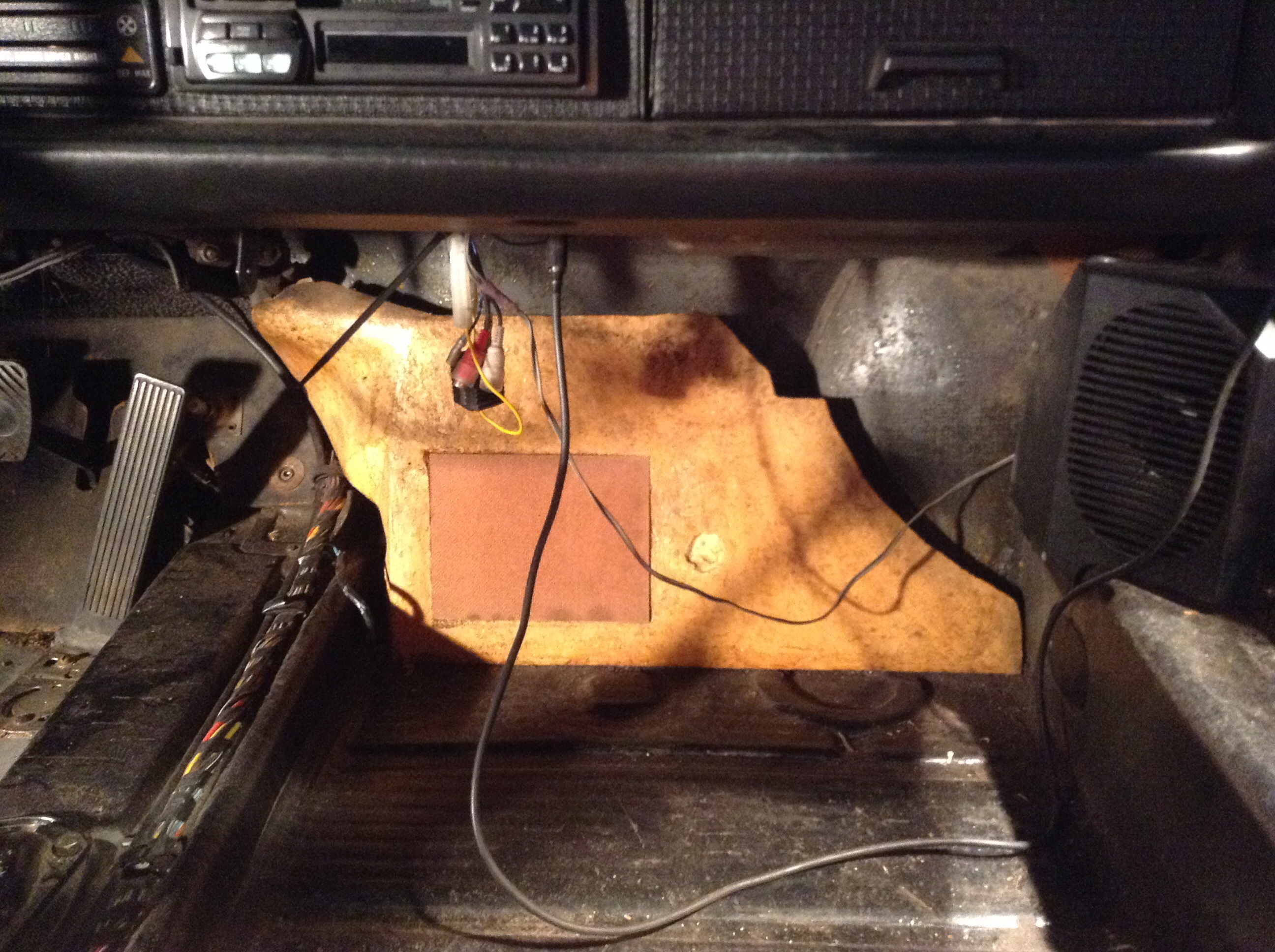

Question here,
is this foam thing supposed to be here? If so, what is it?

QUOTE(dudzy's914 @ Jul 4 2014, 05:22 PM) *
Question here,
Yes, it's the foot rest so the passenger has a flat place to put their feet. The piece of wood in it is a access panel to the EGR counter.

dudzy's914   Question here, is this foam thing supposed to be h...   Jul 4 2014, 06:22 PM
Bleyseng   Question here, is this foam thing supposed to be ...   May 24 2015, 06:58 PM
mobymutt   It's the footrest. I took mine off when I rem...   Jul 4 2014, 06:44 PM
