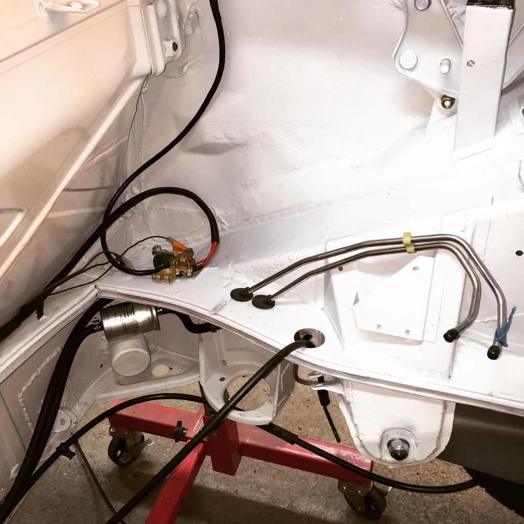

Since last update lots of small stuff has been completed.
(IMG:http://www.914world.com/bbs2/uploads_offsite/matsgarage.com-15176-1432617321.1.jpg)
New fuel pump wiring installed.

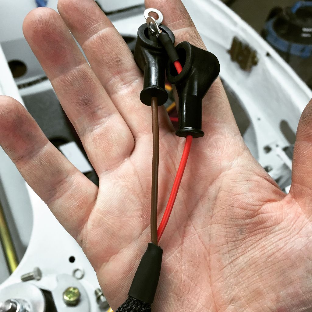

Rear glass and seat belts rollers installed.

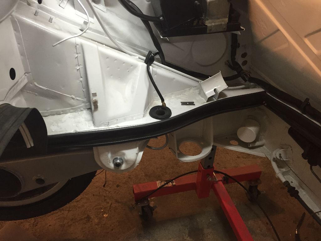

Fuel system completed up to the Engine bay.

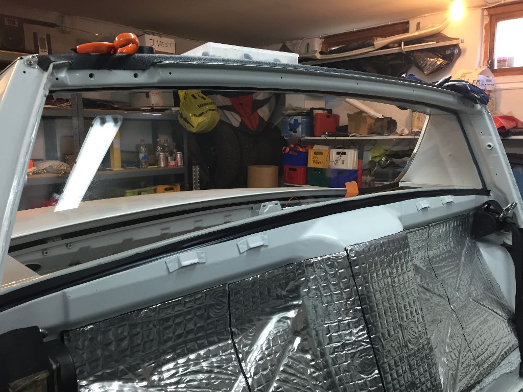

Engine bay rubbers installed, teedious!
(IMG:http://www.914world.com/bbs2/uploads_offsite/matsgarage.com-15176-1432617326.5.jpg)

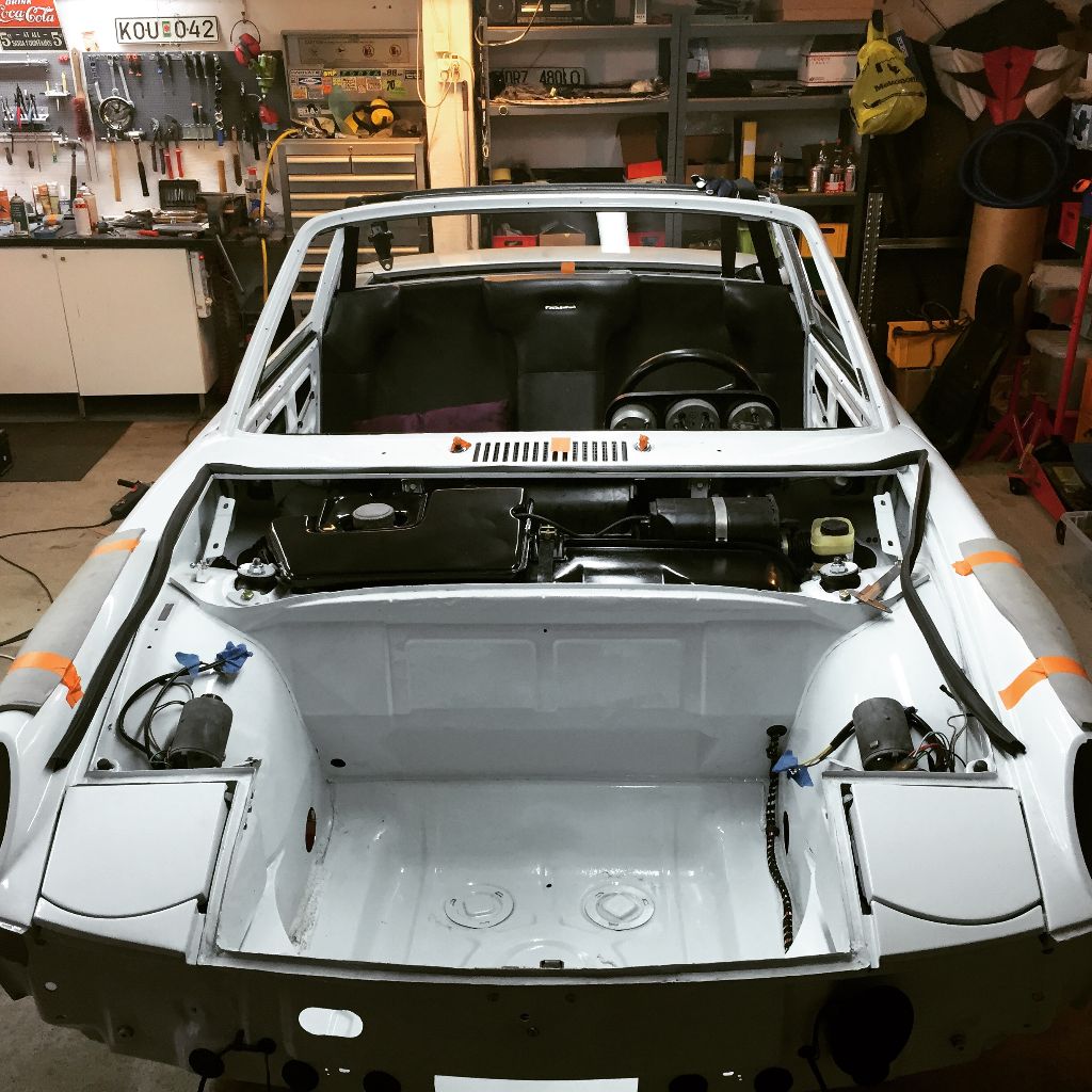

Front end starting to look complete. The new seal for the bulkhead is a Little to tall for my lightweight hood, not sure what to do about that just now...
