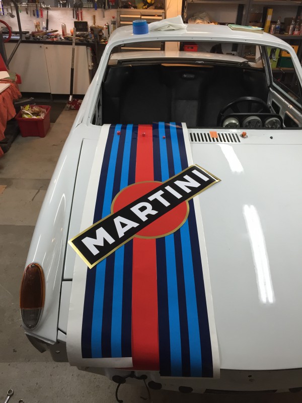

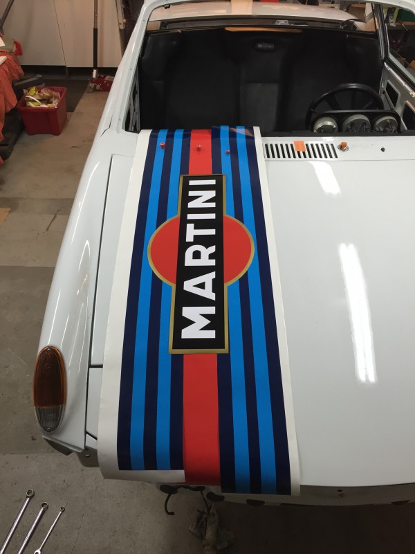

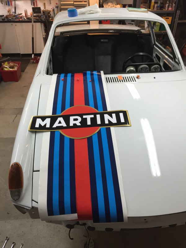

(IMG:http://www.914world.com/bbs2/uploads_offsite/matsgarage.com-15176-1432666371.1.jpg)
(IMG:http://www.914world.com/bbs2/uploads_offsite/matsgarage.com-15176-1432666372.2.jpg)
(IMG:http://www.914world.com/bbs2/uploads_offsite/matsgarage.com-15176-1432666413.1.jpg)
Trying some different layouts of my decals. (IMG:style_emoticons/default/drooley.gif)

turk22   I like the bottom one! :beer2:   May 26 2015, 02:43 PM
SixerJ   I like the bottom one! :beer2: I second i...   May 27 2015, 12:51 AM
thieuster   I like the bottom one! :beer2: Yeah, but...   May 27 2015, 11:43 AM
mgp4591   I like the bottom one! :beer2: Yeah, bu...   Jun 1 2015, 12:43 AM
jkb944t   Bottom one looks best to me too! You are maki...   May 27 2015, 06:07 AM
