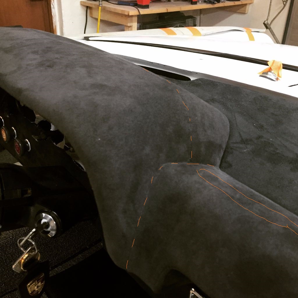

pete000   Love the dash, how did they do that?   May 27 2015, 04:36 PM
falcor75   I'm not quite sure how he did it but I've ...   May 28 2015, 05:32 AM
