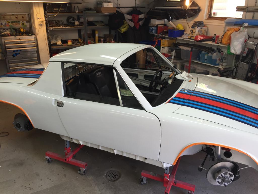

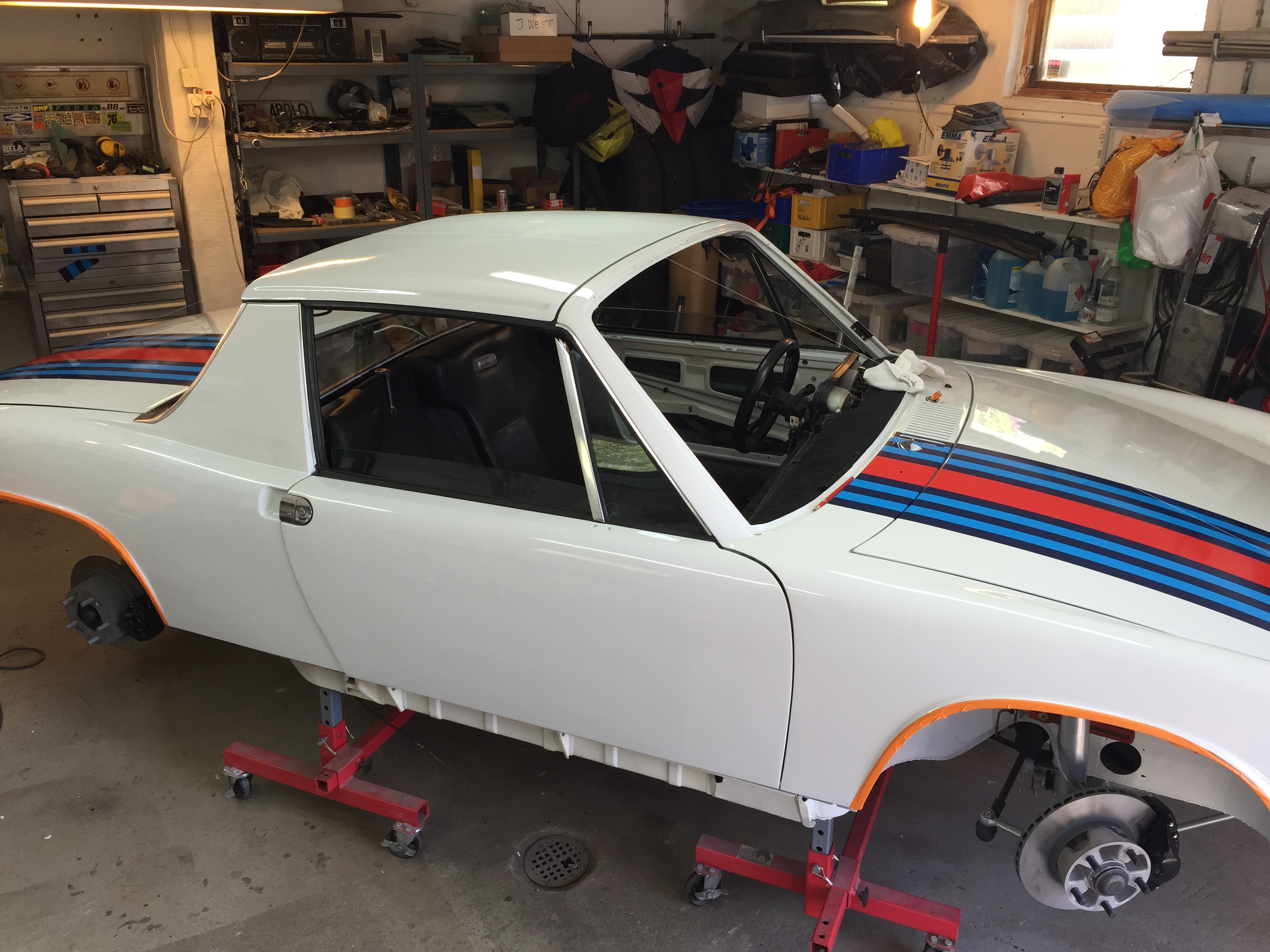

falcor75   And todays work. :)   May 31 2015, 02:34 PM
