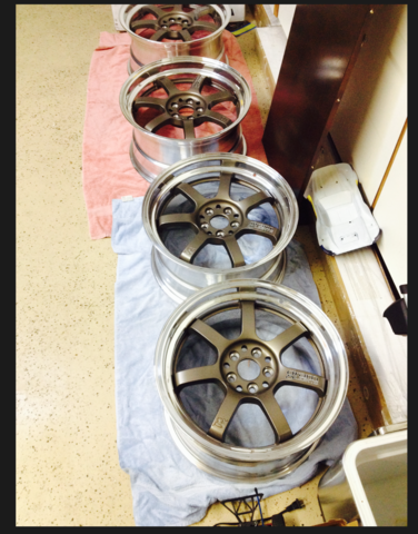

I had a pare of custom wheels from a company in the Bay Area called Memory Fab
http://www.yelp.com/biz/memoryfab-union-city
https://www.memoryfab.com/
They do a lot of high end expensive JDM wheels, but a nice wheel is a nice wheel.
Mine were a set of 1 peice cast wheels that had the face cut and welded into a set of wide forged barrels.
(IMG:http://www.914world.com/bbs2/uploads_offsite/s17.postimg.org-11125-1433369099.1.png)
very nice craftsmanship.
