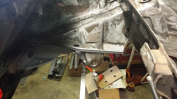

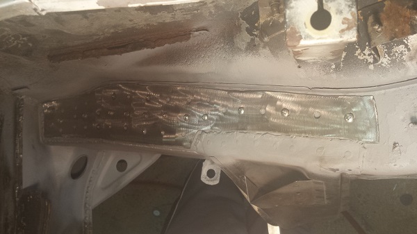

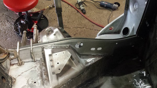

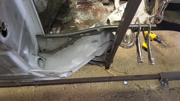

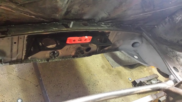

Back to it here.. (IMG:style_emoticons/default/smash.gif) (IMG:style_emoticons/default/welder.gif)
We got the engine shelf in on the right side, added a stainless plate over the hell hole area, started to install the RJ engine mount, and welded up a few areas under the fuel tank. After the engine mount install it's time to tackle the rear trunk pan, install the mad dog kit, and outer frame stiffeners from RD. We are hoping to have all of the welding done by the end of July.. (IMG:style_emoticons/default/beerchug.gif)
