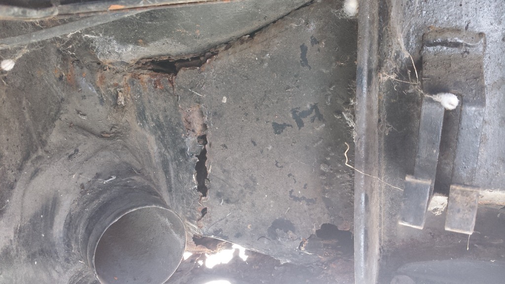

Now that I have the 2.0 running adequately its time to tackle the rust issues...
When I first looked this car over I was so excited about getting it I didn't look as thoroughly as I should have. The cost of excitement I suppose...
Although what I am about to show you isn't nearly as bad as some of the amazing restorations I have seen on this site, I still feel it is necessary to show you what I am dealing with! My hopes are that I can be pointed in the right direction.
I am partially embarrassed to even show these pictures as the rot is minimal by comparison to what I've seen some members work with...
here goes nothing...
all the interior removed:

seat mount is completely gone:
(IMG:http://www.914world.com/bbs2/uploads_offsite/i98.photobucket.com-13631-1432590832.5.jpg)
Just behind the passenger seat... directly over the jack mount area:
(IMG:http://www.914world.com/bbs2/uploads_offsite/i98.photobucket.com-13631-1432590832.6.jpg)
Same area as from the previous pictures only look from under:
(IMG:http://www.914world.com/bbs2/uploads_offsite/i98.photobucket.com-13631-1432591623.1.jpg)
nearly completely separated from the top of the tunnel:
(IMG:http://www.914world.com/bbs2/uploads_offsite/i98.photobucket.com-13631-1432590832.7.jpg)

This is your longitudinal frame rail and structural. This should have been repaired when the PO did the hell hole.
This needs to be fixed before you drive the car.

mepstein   I don't think your rot will be minimal. Pull t...   May 25 2015, 04:26 PM
SirAndy   you will find more rust :agree: That looks pre...   May 25 2015, 05:21 PM

boxsterfan   Looks like the car was POR-15'd at some point ...   May 25 2015, 05:19 PM
Nemisus   I was hopping for a different response but kept in...   May 25 2015, 06:16 PM
Nemisus   Looks like the car was POR-15'd at some point...   May 25 2015, 06:18 PM
boxsterfan   It's a rust inhibitor paint. Problem is that i...   May 25 2015, 06:41 PM
