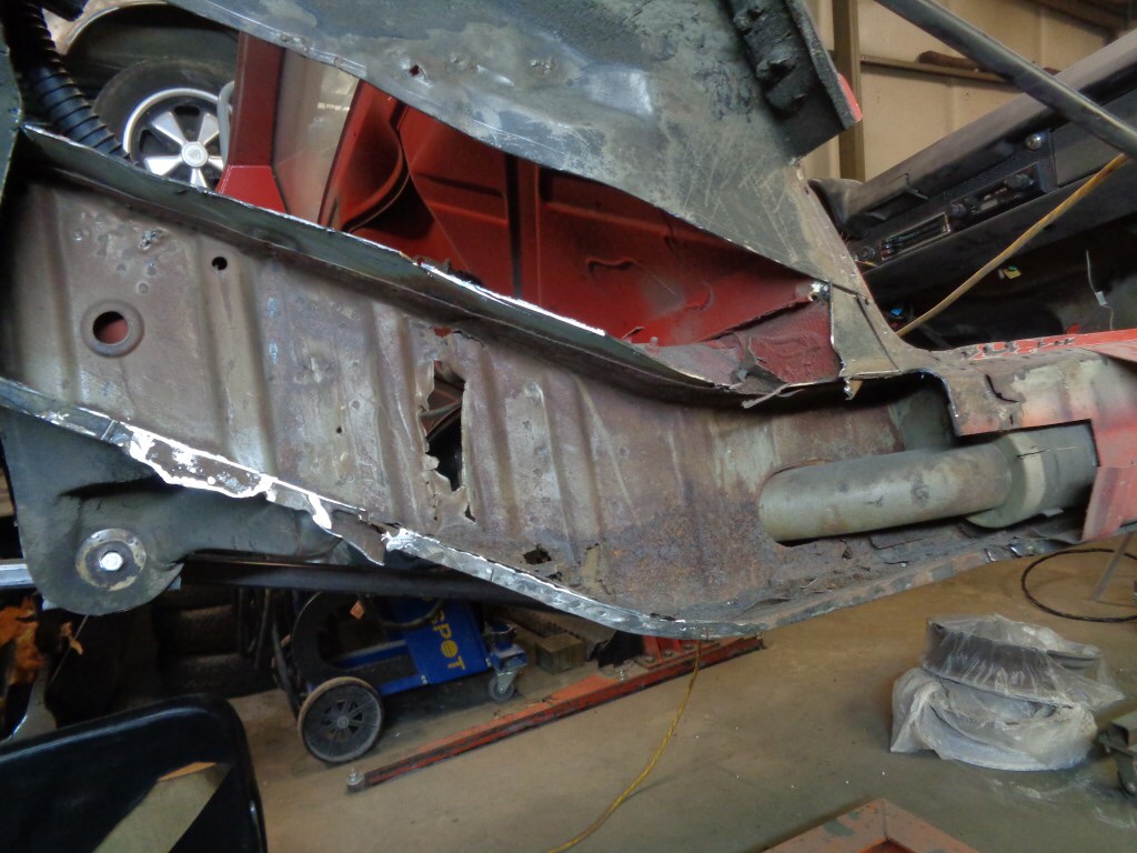

Now that I have the 2.0 running adequately its time to tackle the rust issues...
When I first looked this car over I was so excited about getting it I didn't look as thoroughly as I should have. The cost of excitement I suppose...
Although what I am about to show you isn't nearly as bad as some of the amazing restorations I have seen on this site, I still feel it is necessary to show you what I am dealing with! My hopes are that I can be pointed in the right direction.
I am partially embarrassed to even show these pictures as the rot is minimal by comparison to what I've seen some members work with...
here goes nothing...
all the interior removed:
(IMG:http://www.914world.com/bbs2/uploads_offsite/i98.photobucket.com-13631-1432590830.1.jpg)
(IMG:http://www.914world.com/bbs2/uploads_offsite/i98.photobucket.com-13631-1432590831.2.jpg)
(IMG:http://www.914world.com/bbs2/uploads_offsite/i98.photobucket.com-13631-1432590831.3.jpg)
(IMG:http://www.914world.com/bbs2/uploads_offsite/i98.photobucket.com-13631-1432590831.4.jpg)
seat mount is completely gone:
(IMG:http://www.914world.com/bbs2/uploads_offsite/i98.photobucket.com-13631-1432590832.5.jpg)
Just behind the passenger seat... directly over the jack mount area:
(IMG:http://www.914world.com/bbs2/uploads_offsite/i98.photobucket.com-13631-1432590832.6.jpg)
Same area as from the previous pictures only look from under:
(IMG:http://www.914world.com/bbs2/uploads_offsite/i98.photobucket.com-13631-1432591623.1.jpg)
nearly completely separated from the top of the tunnel:
(IMG:http://www.914world.com/bbs2/uploads_offsite/i98.photobucket.com-13631-1432590832.7.jpg)

My car looked good but was very rusty inside. I am paying to have it professionally restored. It's a good amount of $$$ but it will be done right. I could never do it myself. It would have been way less expensive if I started with a better tub but it didn't. Take your time and figure out what you want. Personally I hate to see projects that someone starts, gets overwhelmed and never get done but that's life.

mepstein   I don't think your rot will be minimal. Pull t...   May 25 2015, 04:26 PM
SirAndy   you will find more rust :agree: That looks pre...   May 25 2015, 05:21 PM
Cairo94507   Rust never sleeps.....ask us how we know!   May 25 2015, 04:43 PM
boxsterfan   Looks like the car was POR-15'd at some point ...   May 25 2015, 05:19 PM
Nemisus   I was hopping for a different response but kept in...   May 25 2015, 06:16 PM
Nemisus   Looks like the car was POR-15'd at some point...   May 25 2015, 06:18 PM
boxsterfan   It's a rust inhibitor paint. Problem is that i...   May 25 2015, 06:41 PM
boxsterfan   This isn't my car, but here is a sample of the...   May 25 2015, 06:48 PM
Shadowfax   You'll want to remove the firewall backpad ins...   May 31 2015, 06:50 AM
Nemisus   Thanks Shadowfax! I am trying really hard to ...   May 31 2015, 10:52 AM

Mike Bellis   This is your longitudinal frame rail and structura...   Jun 6 2015, 10:11 PM
SirAndy   This is your longitudinal frame rail and structura...   Jun 6 2015, 11:50 PM
brant   You really need to look under the rockers. I thin...   Jun 6 2015, 10:49 PM
Nemisus   This is your longitudinal frame rail and structur...   Jun 7 2015, 01:24 AM
OllieG   The Rockers are the trims or skirting that runs un...   Jun 7 2015, 03:03 AM
cary   Restoration Design http://www.restoration-design....   Jun 7 2015, 07:40 AM
PanelBilly   Strip out the interior and pull off the doors. Wel...   Jun 7 2015, 08:49 AM
KELTY360   Strip out the interior and pull off the doors. We...   Jun 7 2015, 01:45 PM
brant   Many of us learned the hard way with our first 914...   Jun 7 2015, 10:03 AM
Nemisus   Okay guys! Sounds like I have some serious co...   Jun 7 2015, 11:40 AM
boxsterfan   Search here on 914world for plans on building a ro...   Jun 7 2015, 12:47 PM
SirAndy   Not that you asked for it, but my honest opinion i...   Jun 7 2015, 01:15 PM
